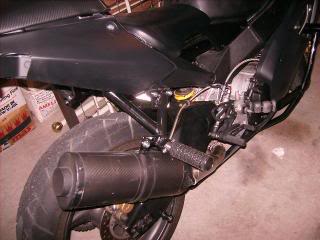

came back to the thread to post the pics. In the garage, so lighting sucks, but for what it's worth, here's the pics of the subcage and the pegs I made at work. Now that she's all finished.....time to wreck it all to hell and rebuild again. I'm down to two SOLID good wrecks and one hospital stay per year.
In the Tucker Rocky catalog they have passenger replacement pegs for $25 (retail) and they screw off the bases. I took those bases (12mm with 1.25 pitch) off, went to the best stunt shop in the world (walmart) and bought some cheap *** mongoose freestyle pegs, drilled them out, put them on the bases, bolted them in place with red locktite, and then mounted the bases on the cage. POW POW.... solid. With my pegs down, they stick out further than my damn cage, but plenty of real estate for your feet.
