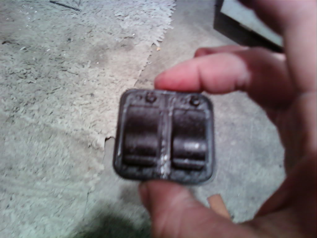

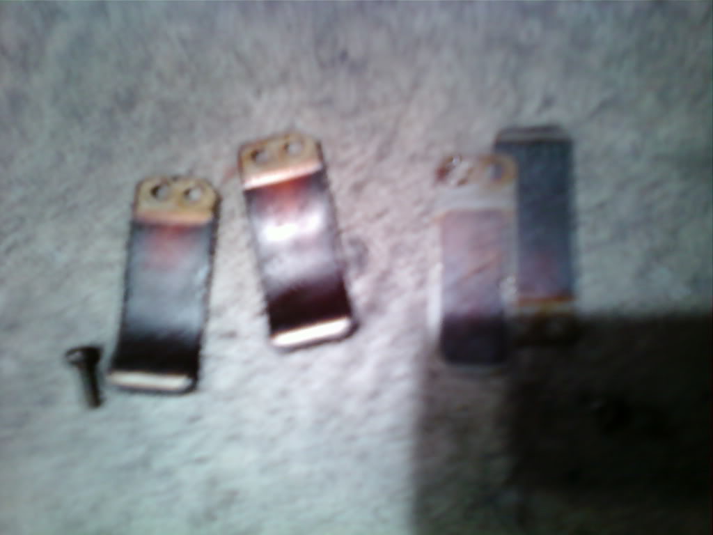

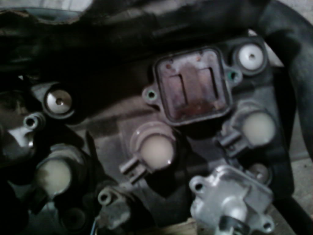

Old Mar 4, 2010 | 09:53 PM
!!A2K!!'s Avatar
The Reverend Freestyle
Joined: Sep 2008
Posts: 1,845
From: indiana
!!A2K!! will become famous soon enough
Re: 09/10 winter project..... 2005 R6 stunt build
this is right ^^^
this is under the breather hose plates
pull it off and on there will be two screws and 2 plates take the 2 screws and four plates OUT
these are the 4 plates and screws
put the metal housing back on the EXACT WAY it came off
then put the breather plate back on and your golden

at first i did the normal air mod like the pic that i just said was the right way.....but I stalled my bike and checked my phone and before I jumped back on there was smoke rolling out my exhaust....when your take the plate and screws out im guessing it helps the oil breathe ALOT! I called cutler and asked what the hell? hahaha but he told me to do it this way and I have no more smoking problems at all....hope this helps ya guys

except for the pic I said was right....keep the stock hose on number 3.....dont run those to each other. run them into the air box. but other than that it is all hooked up right
