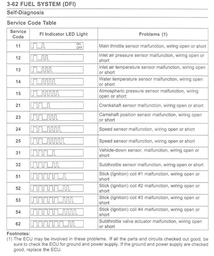

Re: 03/04 636 Trouble Codes Help!!!!
Not sure how you are reading codes. Don't know about a "71"?
Straight out of the 03/04 manual.
Hope this helps some.
