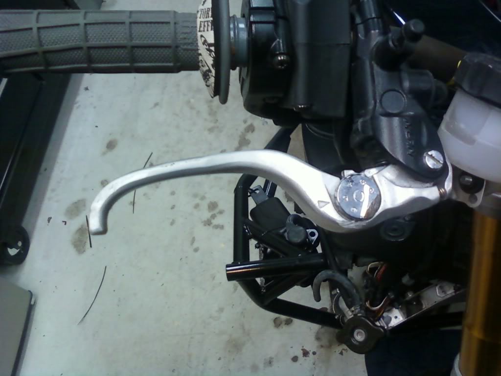

do you have a pic of what you want it to look like

look at his hb lever

like this..........?

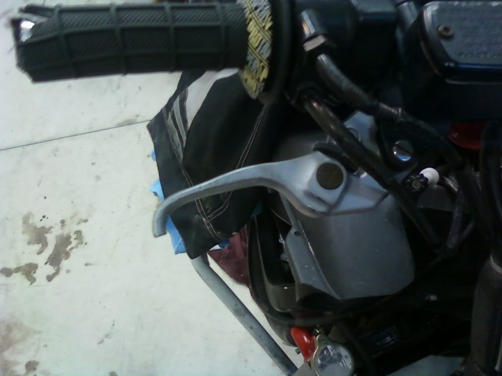

bending levers is easy, dont be afraid to do it. ive done tons. ill post pics of my front levers when i get home. i cut them short then put a 90 bend to make a nub at the end. ive also straightened tons of hb levers. best way to do it is clamp the body of the lever in a vice, slide a small pipe over the lever to about a half inch away from where u want it to bend. pull on the pipe but not hard enuff to bend it. keep that pressure steady then heat it with a hot torch. i use acetlyne, sp? the lever will start to move within 20 seconds or so, bam ur done. that way u dont melt it by over heating. just keep steady pressure and wait for it to move...
thats is nice! with my magura i don't get the adjustment i do with my brembo, so i cant adjust the lever back torwards my bars more like my brembo , so i need to bend it back alittle(its to far from the bars for my likeing) then curl it up
one of my first lot sesions after that bike was set up, i dropped it pretty hard. bike and parts were pretty much brand new. i was pissed at first but then kinda liked the curved HB lever. i did loose a little leverage, so it has its draw backs and benifits. its saved my finger from slipping off a few times.
and as far as adjustment.... it didnt really seem to bing in the lever any closer just bent it at the end into a curl.
Originally Posted by Towlieee
Is that purposely bent or bent from a wreck? Mine looks like that after a good wreck
yeah, check out my post above ^^^^ mine in the pic above was from a wreck. not sure if KK's is or not, but my guess would a drop

Re: bending brembo and magura hb masters???
