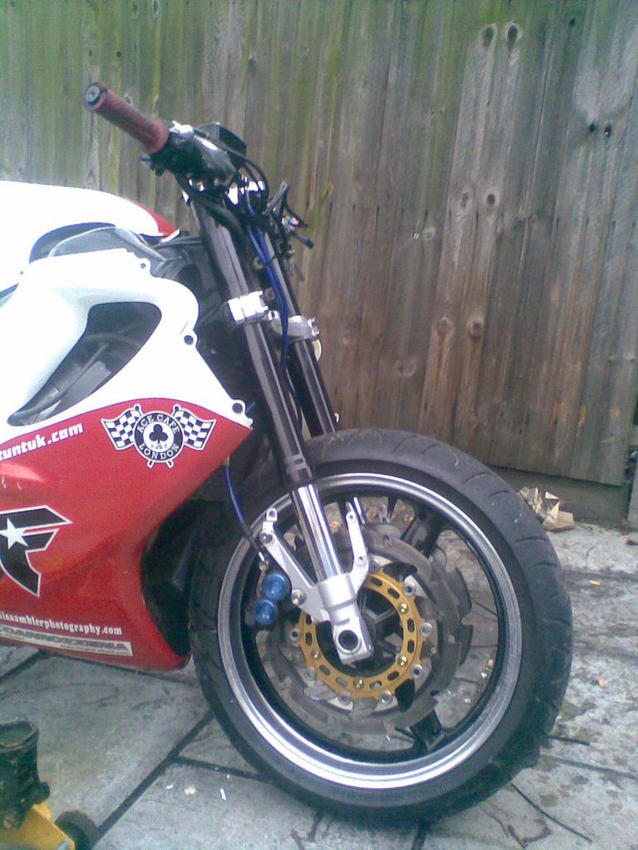

part #6906-2RS
http://www.vxb.com/page/bearings/PROD/Kit7193
this type of bearing replaces the top bearing and frame race.
dont know what year tripples you got but heres a pic of a f4i with r1 forks and 929 tripples. so it might work.

no problem,i forgot to tell you the gsxr, r1 and f4i bottom bearing and race are the same.
