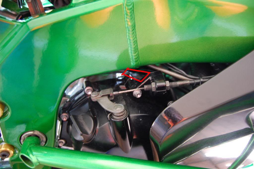

Re: zx6rr and zx6r motor, how to tell the defference?
the numbers are on the right side of the bike just behind where the clutch cable is attached (not the the clutch cover) but on the grey part of the motor
heres a pic of where they are
Thank you sir and your bike build turned out sick
