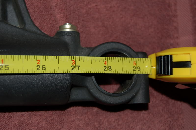

929 fork is 29 1/2 inches...
1000rr tube is 28 3/4
you could ask somone with a 06-07 gsxr frontend to measure there forks, i remember my 97 forks were 32 inches and they felt like stock f4i hieght with the forks above the tripple.
Ethiopian is offline

so is that from total botom to top or is it middle of axle to top??? i already got the gsxr frontend its at my boys house though, hes gonna check in a little

Bottom of axel part to top of fork( not counting the top adjuster piece that sticks out of the top of the fork)
top to bottom(929 tube)
