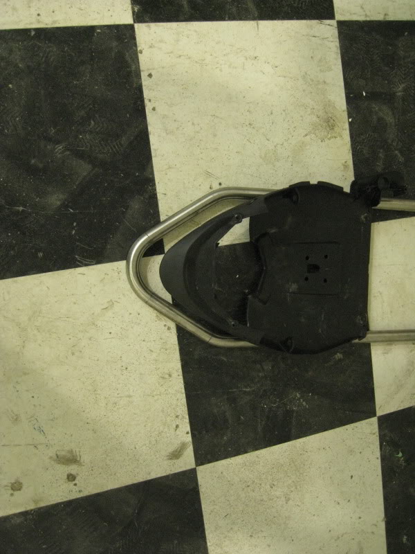

09 ZX6R Titanium round bar preview
So I finally found a company that can actually bend my titanium round stock the way I wanted it for the 09 ZX6R. If you dont know about Ti it has some serious recoil, so basically to get the bend you want, you need to over bend it about %30 and it will spring back to what you need...
I was slacking on this project but my riding season here is pretty much over, so I got back to work on this. And I should have more pics of the finished product in a week or so once is all welded up...I made the complete rear section of the 09 ZX6R subframe out of billet aluminum, and its going to have this titanium round bar that is bent to match the shape of the tail. It is also going to be adjustable, so you will be able to slide it in and out to the length you want....

Next project after this is going to be a billet aluminum 03/04 and 05/06 round bar base unit, with adjustable and replaceable round bars....With the option of steel or titanium for the round bars....
Let me know what you guys think, Im hoping to make the aluminum round bar base units with the steel replaceable round bars for around the same price as what everyone else offers regular round bars for...Then the Titanium round bar will be an option for more money, or an upgrade you can buy separate at any time....

looks ******* amazing!!. lets see that subframe!

Ti is whats up ... thats sweet

I, personally dont really care about round bar adjustability as long as it is clean and close to the tail and round...now if you start working on subframe reinforcements built into a wheelie bar, then now we're talking.

The adjust ability will be an added bonus, because of the way the 2 different metals are being held together. The round bars will be replaceable, and therefore also adjustable...They will come a standard length and if you want it shorter you just have to cut off some material, and it will be shorter when you mount it to the base unit. You wont be paying anything extra for this

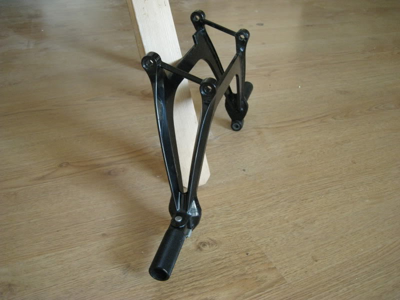

Heres a prototype reinforced subcage made with the stock brackets, that my friends have been using on their 09 ZX6R's....Light, strong and looks stock from the side....

Why would u need/want a round bar to be adjustable? Clean and right at the end of the tail is perfect!
Looks nice though!

That subcage, just like every other subcage on the market Does not resolve the problem of our subframes snapping at the very end where its narrow weak potmetal crap. Run with my subbrace idea...its solid...im too lazy to build them and sell em lol

Because we can, and some people want shorter or longer bars then other people. And it doesnt cost anything extra....It has to do with the way I designed them, replaceable and adjustable come together at no extra charge....
Personally I have my bar really short, other people might want it loner. Why not give people the ability to make it any length they want at no extra cost
Dont want adjust ability then simply dont adjust it

Thats not the point of a subcage, and that one pictured is for an 09 ZX6R which is totally differnt then a 05/06....The 09 has other problems and Ive taken care of those in other ways....
Most people buy a subframe brace or aftermarket subframe, and then a subcage. Building one complete unit isnt the best option IMO, because people that already have one, then cannot use a all in one unit...And also if you do manage to bend or break something, you just fucked a complete unit that is going to be expensive...Unlike when its sperate parts
Everyone has their own ideas, these are mine....The only reason I make these to sell, its because people see what I have made for myself and or my friends. And they want it...Ive had a Ti round bar for about 3 years now, Ive yet to see anyone else make them for sale...So people have asked me numerous times to produce them....
Also I only really make things that arent on the market, or arent made the way Id like them. So when it came to my friends 05/06 636 subframe problem, we just bought a SI subframe.. I was making him one because no one was, but then SI came out with it....So we just bought it....He already had a SI round bar, and a Powerz subcage....So it all worked for him in the end...

man im gonna have to disagree w u. I believe more riders have subcages mounted on stock, nonreinforced subs...
Our industry needs productive parts Such as the dc radiator braces, c4 rearsets, hohey brackets, etc etc ...not squidly adjustable bars and titanium. Train tracks r whack! :2cent

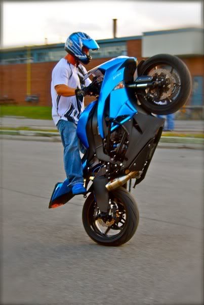

You called my idea "squidly", Im supposed to take that as critical imput, not an insult? Give me a ****** break!
Here you are telling me what "our industry" needs, when you dont know who Im making this stuff for. Or how many requests Ive gotten for Ti round bars...
This is my customer, and he wants an adjustable Ti round bar, no matter how squidly you think it is...The subcage seems to be working for him too
