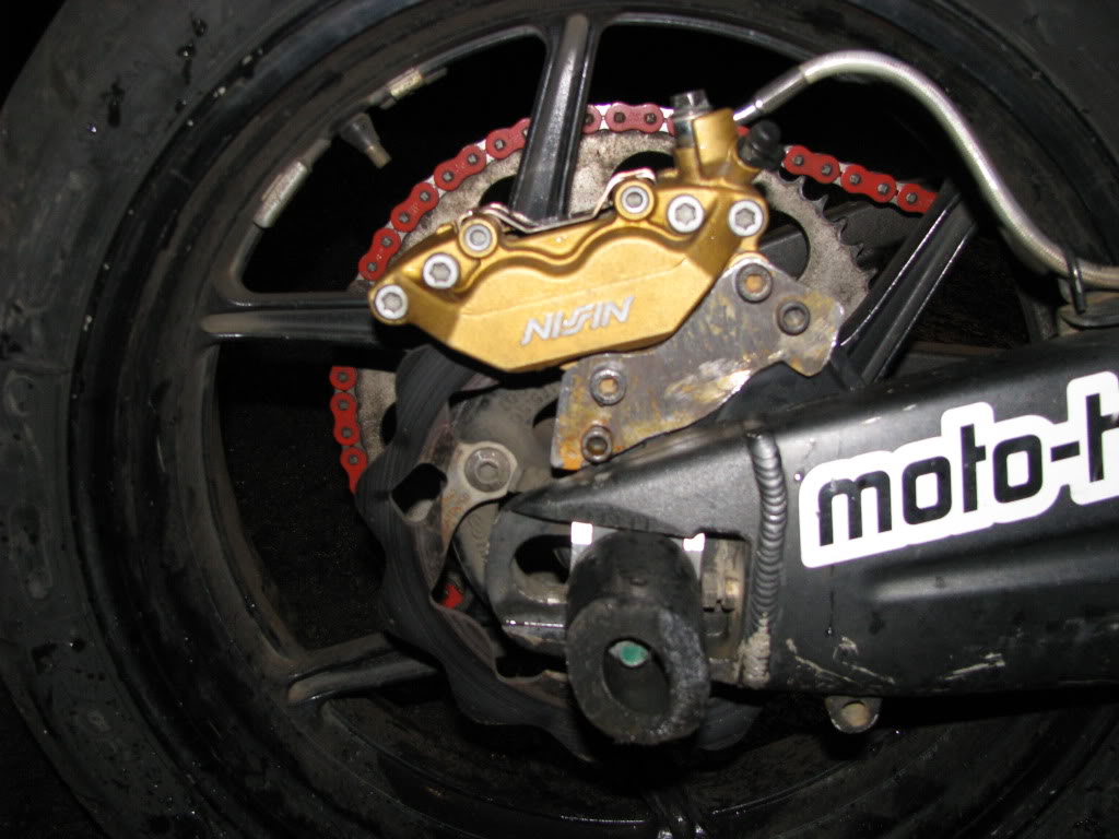

Old Sep 21, 2009 | 03:57 PM
cjoec01's Avatar
Bacons Hot, Need a Spot
Joined: Jul 2007
Posts: 1,347
From: Kauai HI, free today FTP
cjoec01 has much to be proud ofcjoec01 has much to be proud ofcjoec01 has much to be proud ofcjoec01 has much to be proud ofcjoec01 has much to be proud ofcjoec01 has much to be proud ofcjoec01 has much to be proud ofcjoec01 has much to be proud ofcjoec01 has much to be proud ofcjoec01 has much to be proud of
Re: Dual rear Nissen caliper set up
I made my own adapter plate as well but its on the stock sized rotor. Shimmed with washers.
Rounded offf the edges and painted black now.
