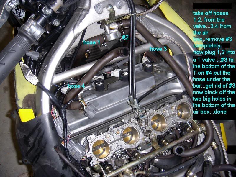

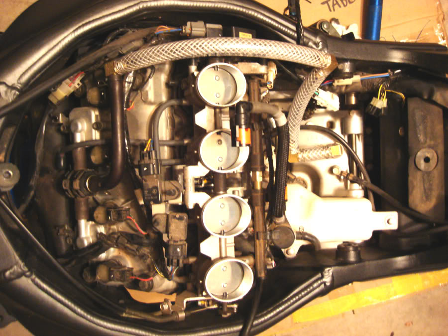

Hey fellas... is this what mine should look like?

here ya go
https://www.stuntlife.com/forums/443...=kleen+air+mod

Originally Posted by tricky500
Thats not a 636

ahh good lookin out i didn't even pay attention to that.
http://public.fotki.com/garymilcheck...ods/kleen_mod/

[quote=JSkillz23;4109270]Hey fellas... is this what mine should look like?
Yea men thats how it has to be..

[quote=Monblan;4109642]
No you need to cap off the little lines that come from that emitions valve, and the ones on the air box(dont know if they are cant see)
