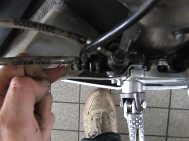

Old Jul 26, 2009 | 03:21 PM
Re: Whos got their 2 rear calipers linked together for their handbrake
heres da liks set up

Old Jul 26, 2009 | 03:24 PM
