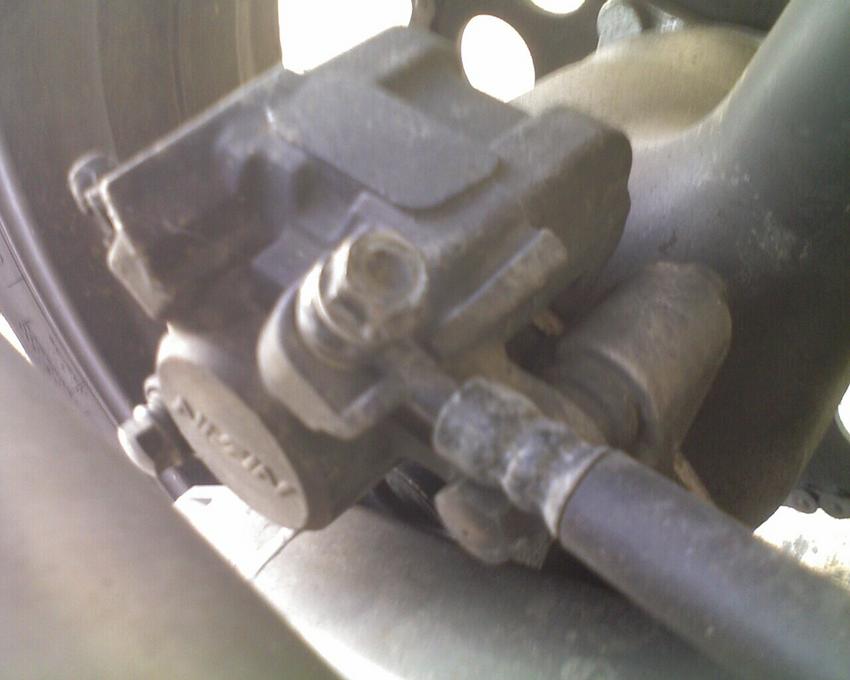

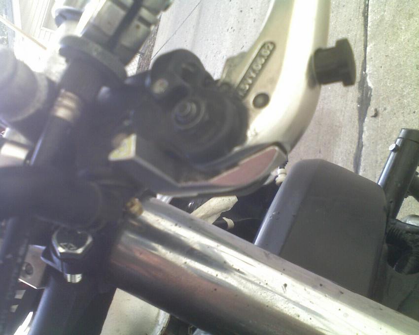

These help any?
ID:	228278   Click image for larger version
ID:	228279   Click image for larger version

you probably have gixxer or honda 1000rr radial master handbrake but lets wait and see what their input is.
Old Jul 18, 2009 | 09:59 PM
*Tanus*'s Avatar
AZ's Finest!
Posts: 4,227
From: AZ streets
Re: Handbrake question??
thats r6/r1(16mm),should lock easy with 2 fingers as long as its blead good,if its not blead good you'll be able to squeeze it all the way to the handlebar. If its blead good and it still sucks Id get a new set of STOCK brake pads.
thanks man.. putting brakes on tomorrow
get some better lines. i have that same master. its off an r6 and sucks a gang of dicks with my single piston too. u just gotta start using the left hand more for the meat beater
