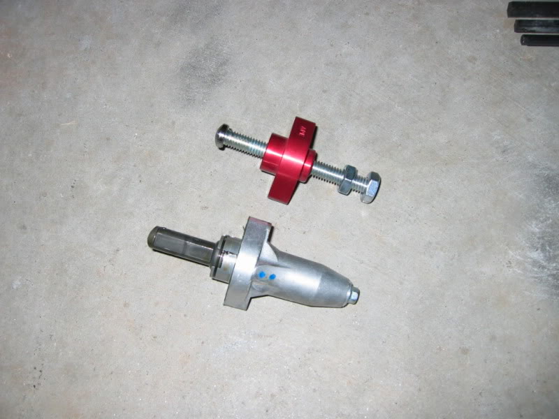

I don't know how these things work but why cant you just re-adjust the tensioner thats already in the bike?
-Jesse

it's rattling because it's broke
-Jesse
It's not adjustable. (well it is but that won't fix your problem)
The reason they rattle is because the hole press pin that holds the tip on is in wears and leaves slack. That fraction on a mm is enough to make a harsh rattle when it's amplified through your cam chain.
There's not really any danger of your chain jumping timing because the internals have a ratcheting device inside that only lets it expand out, not in.
The manual ones aren't that bad to put in. you will have to adjust it eventually
Just cut your pipe shorter and forget about it

I just put in a cct last night and its a bitch, helps if you take off the tank and airbox and have shorty 1/4 drive ratchet with 5mm allen and shorty 5/8 open end wrench or ratchet wrench for adjusting the ape tensioner.
