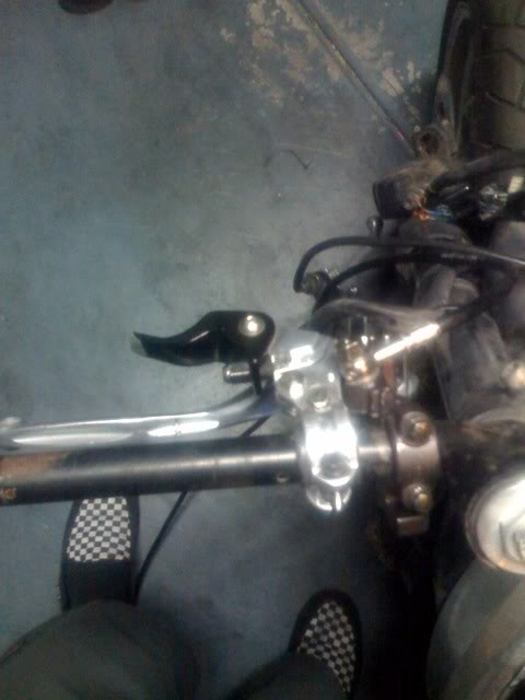

Ok so I just got this F4i and Im trying to put the HB on..... Please assist me... I've tried all variations and this is the closest that I got but the clutch is hitting my finger......??

Get a moose easy pull. The lever is shaped perfictly to fit around the banjo bolt.
When you get it put the clutch on the other side of the master so the the banjo bolt is in the bend of the lever.
Your lever is way to short now
Yeah, I was lookin up some pictures and saw that alot of em had that moose lever.... I'll have to go get one.... Thanks

ops actcually looks at the pic so your clutch is hitting your banjo bolt and cant tak it any higher i run a msr ez pull and a brembo and it got pretty good adjustment on it

LoL DUH!! I've moved em around in all different positions... This is the closest I could get it to working, but its obviously still not
Yeah, I think Im gonna have to get either the msr or moose... Those seem to work in pictures that I saw... If anyone has pictures of there's, post up... That would help alot....

swap where you have mounted the clutch and handbrake. put the brake on the outside and cltuch on the inside. then you can get more pull on your clutch and still have plenty on the brake if that makes sense
