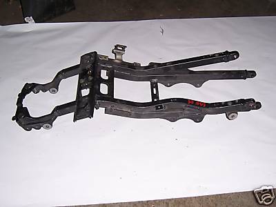

Originally Posted by serious
Yeah, I think kawasaki figured the sub needed reinforcing. Glad to hear you got the 2006 subframe trix.
Look at these two pix. One of a 2005 and the other of a 2006 subframe. just below the seat latch, the crossmember is what you need to focus on. the 2005 has a straight one and the 2006 has a arch-like crossmember. that arch-like crossmember is what keeps my sub from snapping. I'm not saying that the subframe is a strong as the SI sub but I'm just saying the 2006 is a lot better and if you're careful, you may not need to spend $400 on an SI.
I honestly am not seeing what your saying sorry cause both subframes in the pic are flipped dif ways sooo maybe its cause of that but I really dont see it

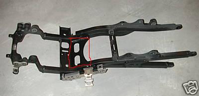

sorry try this. I circled the area with a red pencil.

that arched section on my sub cracked along with the snapped square tube there by it. I wouldn't count on it lasting very long.
