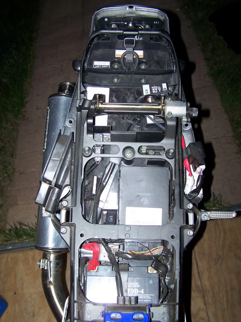

Originally Posted by YogiR6
how did you "fix" the ti[ over sensor. I didnt even know that bike had one.
Originally Posted by twlvoclckstndup
How do you bypass the r6 tip over sensor??
Thats what Im Screaming
Its been a few years.... So I don't remember 100% how I did it, But you need to take it apart and fill it full of silicon... Use a very small flat blade screw driver to "pop" the white inside out of the black case...
Look for the sensor just behind the ecm, it has 2 bolts and says "up" on it
