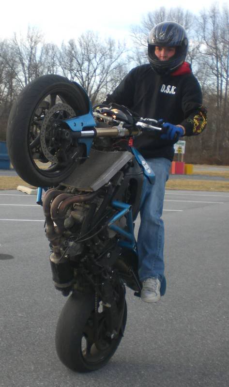

Originally Posted by sixxxer-fuddy
sooo...stunter with attitude what are all the mods u have done to yours?
hes got klean air mod
clutch switch
no secondary butterflys
custom subframe
powder coated parts (make pull harder on idle)
SF fairings
A Gangsta cage
next you ask me what i got
i got homade 25$ cage
flipped clip ons ez pull clutch
powers subcage
powers round bar
reinforced subframe with steel plating
set valve wired open
clutch switch taken off
and blah blah blah
what i can do with my gangsta gix with few "mods" lol

how do u do the clutch mod and what does it do?? and for the set valve mod u just cut that wire?
Old Mar 1, 2009 | 07:01 PM
  #94
Neosporin's Avatar
Joined: Aug 2008
Posts: 400
From: North Florida.
Neosporin is a decent person
Re: 07 GSXR 600 setup?
Remove the switch and zip tie it out of the way. that's the clutch mod.
Set valve; cut wire and remove stuff.
Old Mar 1, 2009 | 10:31 PM
  #95
sixxxer-fuddy's Avatar
Joined: Jul 2007
Posts: 379
From: Prince george B.C. canada
sixxxer-fuddy is a decent person
so the clutch mod is just forthe kickstand thing ??? i just ziptied it closed
Old Mar 1, 2009 | 11:04 PM
  #96
bulgarianMike's Avatar
Almost Don't Count
Joined: Jan 2007
Posts: 1,268
From: Maryland/Bulgaria
bulgarianMike is a decent person
lol no the clutch mod everybody said on the thread just take it off and zip tie it to the side as you did, i didn't know it was some kind of a mod when i did it last year and i just cut the wires and tied them together, the kick stand is totally diff thing because lets say you go thro a bump and the kickstand just moves a bit and it kills the bike than you are done, lol , there is a green and black wire coming out the kickstand i cut them and tied them together also
