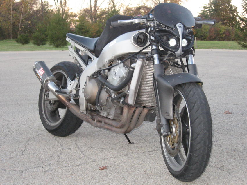

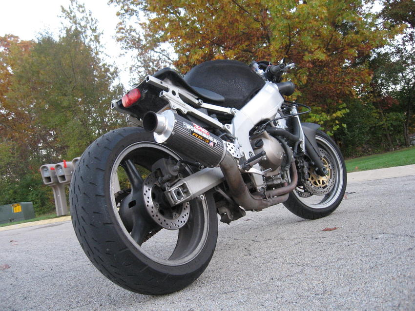

Fighter that POS

FYI if you want it streetable you need to have the ram air tubes on. they duct into the float bowls to pressurize them, after jetting for the shorty they were really needed. i had a high flow air filter on with the new jets but it you have significant gains in hp and driveability with out filter at all, just have to change oil more often.

squid, what tubes? the short black fitting in the frame like yours or the whole airbox has to go on? Is your bike legal with no blinkers? anyone know the cheapest place to get a cage for my bike?
needed to pressureize the carbs?
So what happens when your leaving the line, or doing a wheelie? Ram air tubes would cause RESTRICTION.. Not pressurize! Not until your at high speed on 2 wheels
and no air filter at all? Might as well pour some sugar in your gas tank, and leave your bike parked under water while your at it!
try to refrain from giving shitty advice.. just because you like to destroy your bike, doesn't mean other people do!
IF you NEEDED the ram air tubes, and NEEDED no air filter, then it sounds like your bike was jetted to rich, therefore needing more air flow
