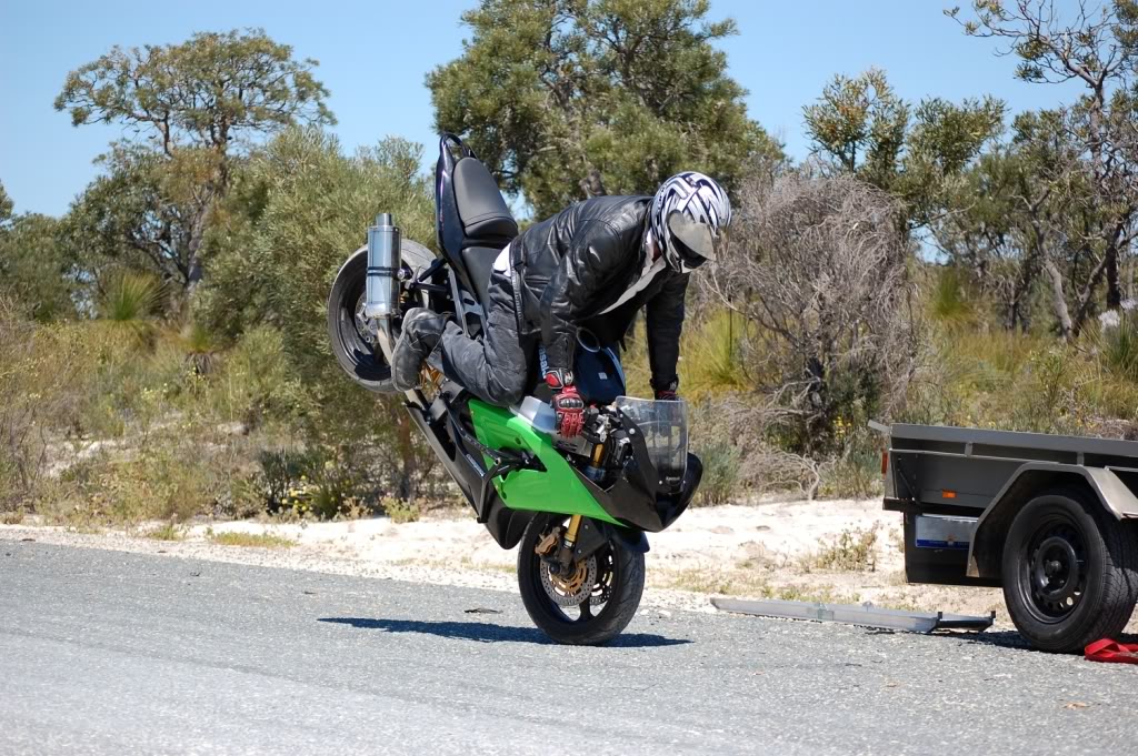

my old forks (even with bombed internals) slmost bottemed out during stoppies

you fat bastaad ....lol j/k

please use two fingers on the brake ....and the **** ....lol

trust me i would loved to be shorter

two fingers is better now omr
ever since you have me the tip
ill get some pics of stoppies tomorrow
