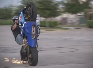

i learned on a 05 gsxr 600, with 3 up in the rear, it's real smooth and not that hard, but not a bike for scraping and bar tricks...i used a stock subframe with shitty 905 bar with tons and tons of bracing throughout the subframe, square tubing and ****..it was somewhat solid.

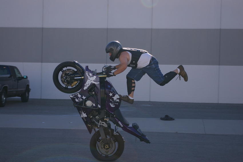

but what you have to do is buy a fine thread 10inch or so idle screw or just buy another stock one from your bike. take out the idle screw that is in there on the left side of the bike and screw this one in and let it hang out. ziptie it to you cage or something.
if look closely at the picture ziptied to my cage is an idle screw that is coming out. you can see the black top part of it and the whiteish part of it to the right of the stator cover under that one star. do it something like I did.
