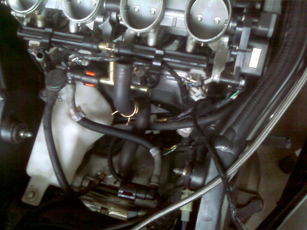

see the big hose in the picture above ,the one that has a black hose clamp on it and it isn't connected to any thing on one end ?

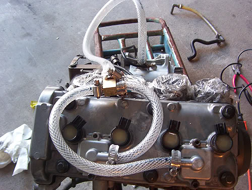

that hose needs to be connected to the big hose with the gold hose clamp on it in the picture below ,it also isn't connected to any thing on one end ..
ok now there is a little vacuum line in the first picture that goes to the back of the clean air valve thats the black plastic thing that the first big hose i talked about is connected to you need to take that little vacuum line off the clean air valve and put a long screw in that vacuum line and thats all you have to do to the hoses and lines..
the only other thing you have to do is plug the holes left in your air box that the two big hoses you connected use to go to....
you can replace both of those big hoses with one long hose or you can connect them in a number of ways but the objective is to by pass the air box....
i like to leave all the little factory vacuum lines hooked up and just plug the one little vacuum line off the pair valve with a long screw or bolt because those little vacuum caps in the picture you posted like to pop off or they just get hard and crack and that makes it a bitch to find the vacuum leak...

Thanks alot this has made my life so much easier. i will do it these days will get back to let know if everything is ok. ) many thanks
