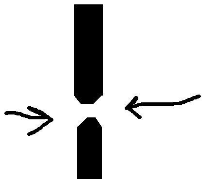

Originally Posted by kaoskid612005
I knew this was going to happen one day. I hit the tail doin a wheelie and jammed the brake to hard. bike slammed to the ground. good thing i was goin slow, landed on my feet didnt get hurt. Ive read that people here tig welded the frame plenty of times. Do they hold up? Should i have a shop put reinforceing plates to?
It broke right on the weld!
If your gonna have someone tig weld it.. its going to be rough. theyd have to cut it down.. build it up like a bevel edge.. and then weld each side..
(TO DO A PROPER CERTIFIED WELD) but since the frame is " Hollow " your fucked.. ( YOU CANT WELD IT FROM INSIDE THE FRAME
The weld will never be strong.. and one day its going to break if you do weld it from one side..
If its a lot stunter... u might be able to get away with breakin the weld all the time and stuntin it..
IF u ride ur bike like u hate chicken ( CHICKEN STRIPS)
Possibility of really hurting urself
not my 2 cents.. my ten dollas- im fuckn rich bitch
Here.. Just incase noone understands what I meant..
Imagine you rear set.. Broke in half .. (Skinny width part) - with that kind of crap aluminum..
You'd have to grind it down.. about 10% of a inch.. and then.. Weld up to build up that loss.. Then grind the edges.. and Weld it from BOTH SIDES
In order for a propper weld on ur Skinny frame.. youd have to do this on ur crap *** aluminum frame to make a strong weld..
Gay i know !
if you want to be safe on ur bike.. Id order a new frame.. or get one on ebay if possibe.. about 1000 unnafortunatly.. SO thats what I would do..
Or id ATTEMPT To weld it from one side as thats all u can do.. and ONLY spot stunt it.. Dealers ****** RED X those frames n ****..
and make sure that weld if done.. is HUGE>. **** a puddle.. make it a lake.. your going to want to build it tall.. and wide.. to reinforce it.. No more pictures.. but a True tig welder should know how to make it as strong as he can
LATE EDIT: didnt knwo it broke on the weld.. Well.. See that bevel.. make it more of a POINT.. and u might beable to weld it back.. GOOD LUCK!

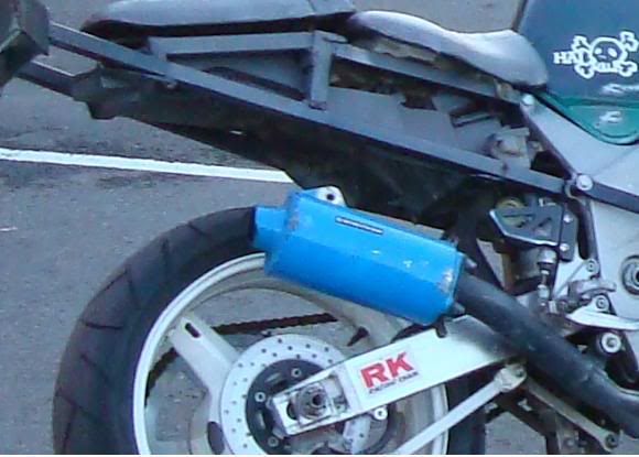

Just rebuild the subframe into steel like i did.. I renamed her the TANK
after that ****.. toughest ************ in the world with a Sick Innovations cage
Look at this thing.. ITs a TANK!!!
Then you drill out the bolts on the frame ears or put low grade bolts.. so they break before your ears do.. Then its golden

Wow, most people just extend the swingarm when they want to stretch their bike....way to go all out!
Old Jul 29, 2008 | 12:35 AM
  #34
ecthemc's Avatar
Joined: Jul 2007
Posts: 1,087
From: Anchorage, alaska usa
ecthemc is a decent person
Re: what should i do?
hahha yea it is a bit long

if you get a good welder that bevels it 15 degrees and taks a 1/8" backing strip behind it it will be a full penetration weld. you can also have the weld re-enforced with a wrap of some sort and weld it to the frame as a brace.. it can be fixed but you need someone with some quality and thats hard to find now adays
