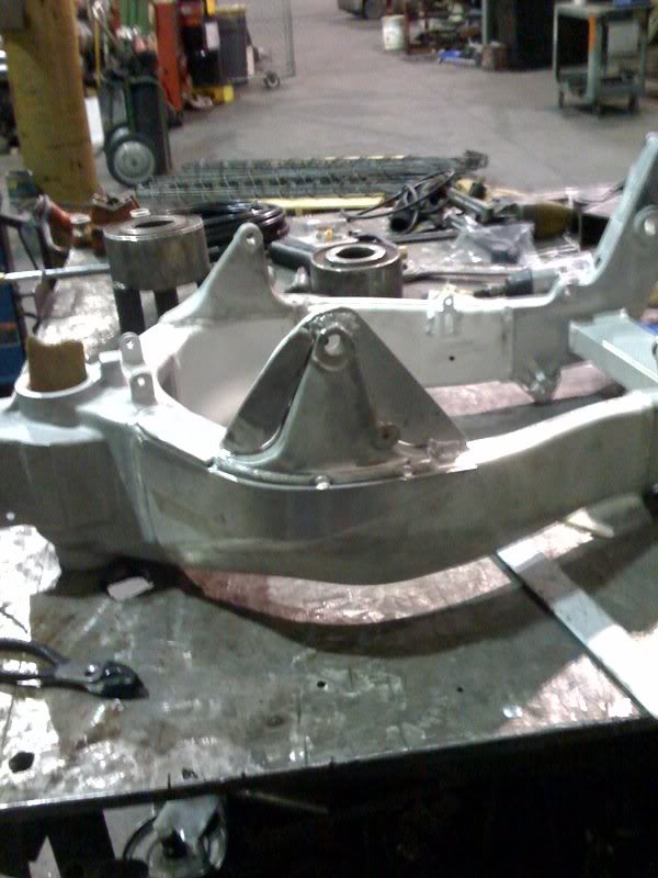

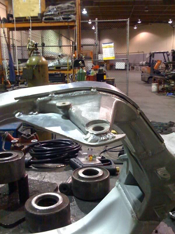

i know it doenst look to fancy yet... still got alot of work to do... these are the pics so far till my phone died.... last one is the start
and i decided to heat treat before powdercoat haha

was your frame starting to crack?
and whats with the support either side of the engine mounts?

Re: frame alloy? 6061?
MR. Zackie Chan........ says.. he has broken a many 636 frame...
and this is what he did to fix.... so no argue'ment thats what i done do ing!
this is by far not done... jus giving you people an idea of what im doing....

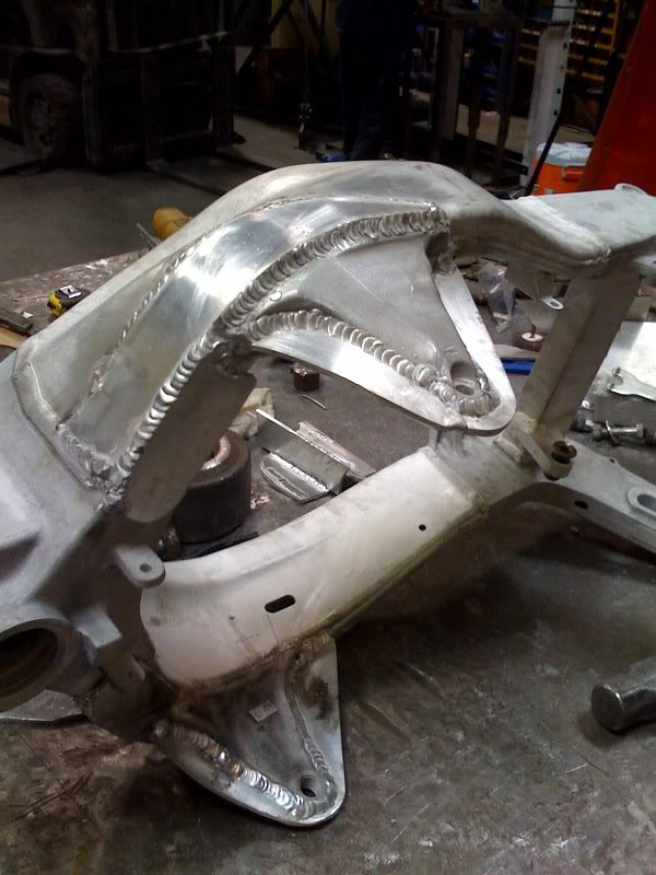

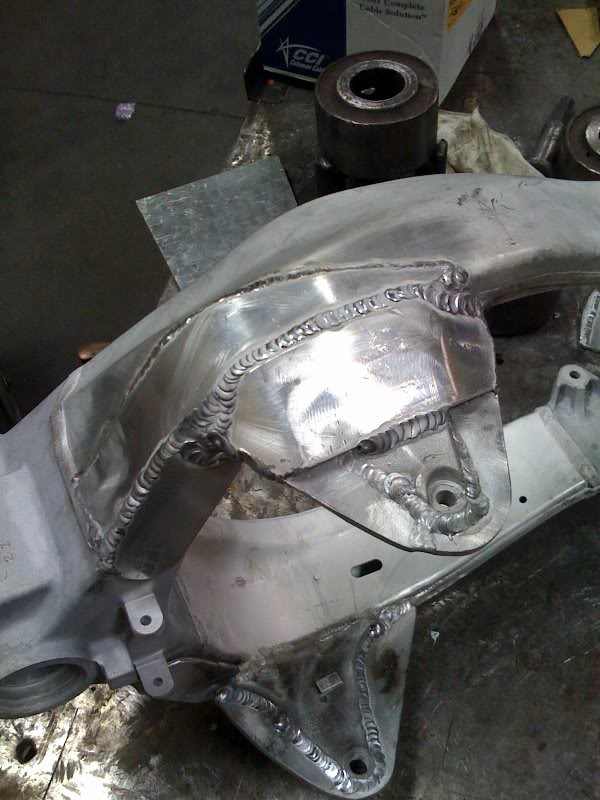

heres some more updates of what i woke up at 6 am to work on....
Hopefully you're gonna bondo that all up and get it powdercoated when you're done?
bondo an powdercoat? i dont know if you can do that...
but its a stuntbike... function over form....:YEAH
but it is geting powdercoated.....

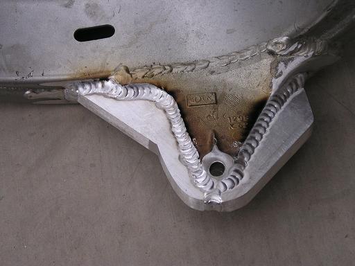

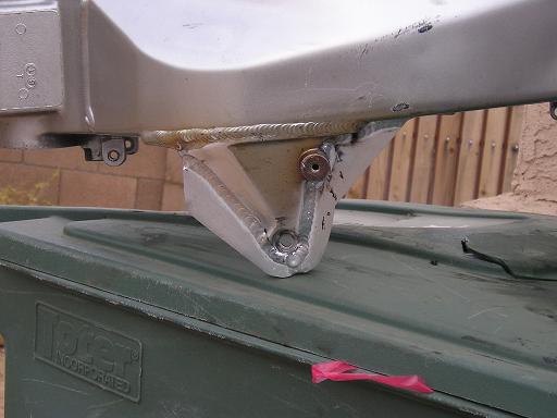

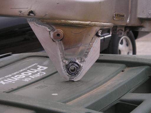

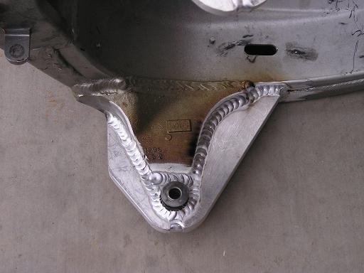

frame looks good. its true about the frame cracking (or braking right off ). look at this pic of zackie chans frame, notice the weld right above the motor mount going horizontal on the right side of the bike. i used 1/2" 6061-t6 for the braces and he never had a problem after that.
he sent me pics an they were like mine.... those look nice too thou... better welds but hey i got ALL sorts of excuse.... but none of them make my welds look any better
Old Jul 20, 2008 | 04:02 AM
  #38
g1kon1wheel's Avatar
Posts: 81
From: az
g1kon1wheel is an unknown quantity at this point
ya. these are like 4 years old and was the first frame that he had problems with, and they show a good pic of the brake on the right side. just take your time on the welds, don't rush it, and you will do fine. thats the thing about tig welding, the more you do it the more comfortable you get the better consistancy you will have.
