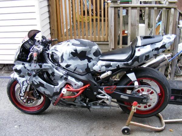

i only have one of mine right now
Old Jun 12, 2008 | 09:26 AM
Insane J's Avatar
Joined: Nov 2005
Posts: 3,072
From: Holland
Re: 1000rr front end.
but I was escpecially reffering to a 954 with 1000rr forks... I never really saw good pics of that...
Your bike is sick Havok. :YEAH
How is the front fender holding up? I kept breaking the 954 1. Ill post pics up after I bleed the brakes and take it off the jack.
