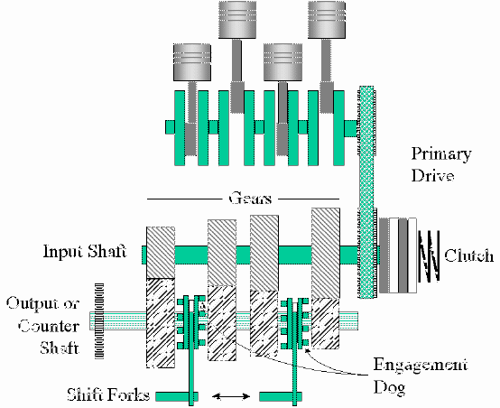

A motorcycle tranny is a constant mesh design, all of the gears in the transmission are in constant engagement with one another.
Here is a basic tranny concept, explain to me how in a constant mesh gearbox shifting without the clutch is not bad...

Wrong.
my bad then ive just leared that since i was a kid

Read this article and it will answer all of your questions. http://www.f6rider.com/VRCC/tech/trans.htm
Notice it doesn't say that clutchless shifting is bad, doing it wrong is bad. Makes since right? Most modern manual transmissions (auto or motorcycle) use free spinning gears that are constantly meshed and engaged to the output shaft via collars with lock dogs. In order to shift you need to take the pressure off of the lock dogs so that they can slide in and out of the gears. You can do this by pulling the clutch or by momentarily reducing (not completely closing) the throttle so that the engine is not accelerating or decelerating. Can you do this perfectly? Of course not. But you can get it close enough to work. Unless you seriously fubar, you're not going to cause catostrophic damage to your tranny. You probably will however, cause slightly more wear and tear than using the clutch.
