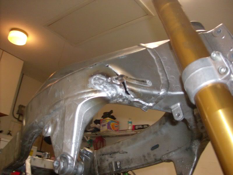

Here's one. The cracked started away from teh weld, then made its way to it. It also wnet all the way up the back side following the weld.

Wow!!! Thats not what i thought

hahaha i see you tried the drill hole to stop the crack , it was a little too little and a little too late for that
HOLY ****!!!
I was getting desperate at that point.
It actually slowed the crack from going upward a little, there was nothing I could do about it attacking the neck weld.
I was going to say get it welded then a plate welded on top ,but that frame is toast, I would buy a freash one and get it renforced before you ride.
