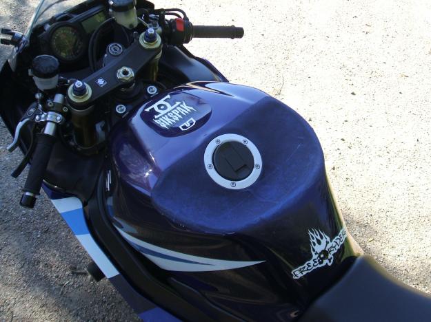

My tank after about 30 minutes with a rubber mallet (I don't have a dead blow hammer, so I grabbed what I had)
Beat my tank soo long my arm was sore, and I had to switch arms...
Then I paid a friend money to braze 3 holes shut that I put in it
Then a bunch of bondo, and HAND SANDING
And I came up with this.. I love it.. Holds my *** and legs perfect..
Before I beat it in this deep, I couldn't clutch up spreaders/hc's AND cover the brake
Oh ya, and thats hc's and spreaders with no grip tape lol.. Haven't got any yet
edit: hmmmm.... the color AND pictures make it soo the tank doesn't look like its dented that far.. Trust me, its dented about as far as I can..
The gas cap opening is pressing against the bottom, and it takes FOREVER to fill with gas lol..
Not to mention, the tank dent goes way back, and feels weird when riding the bike normaly (my ***** damn near hang over the lip of the tank lol)

LOL you dont have to beat your tank long man its a 5 minute job at max. Just grab a felt marker, Mark out where you want your dent. Use a rubber hammer to outline the outside line with small dents, then put a rag on your tank grab a cinder block and hit a few times till you get it deep enough. It will follow outside line and make a perfect shape in next to no time.

I was just barely hitting mine, trying to make it the 'perfect' dent before bondo
My old dent, was shitty. you could physically see the dents where the hammer hit..
This time I did my best to make it a nice smooth dent.. It was definitely WAY better then my old dent, just took forever
I shoulda took a picture before I bondoed it.. It was pretty damn smooth for no bondo yet
My old dent, as well as my friends current dent, are a joke
http://img401.imageshack.us/img401/2065/dsc00002nz2.jpg

On my next tank dent ill take pics of the whole prosses which will be sometime in the next week. The cinder block serisously makes a PERFECT shape, no creases it follows the outter edge perfect no nothing needed because it makes it perfectly flat. Follow it up with a ballpein hammer for the few spots that may need it and you wont need bondo at all. Ive done two tanks like this now and i swear its the best way.
