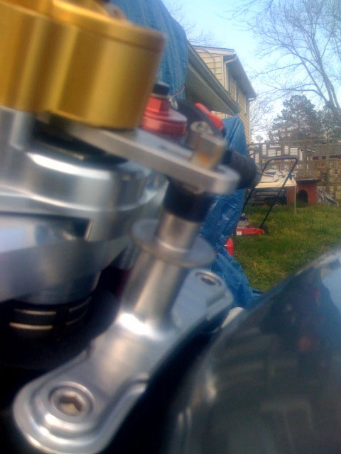

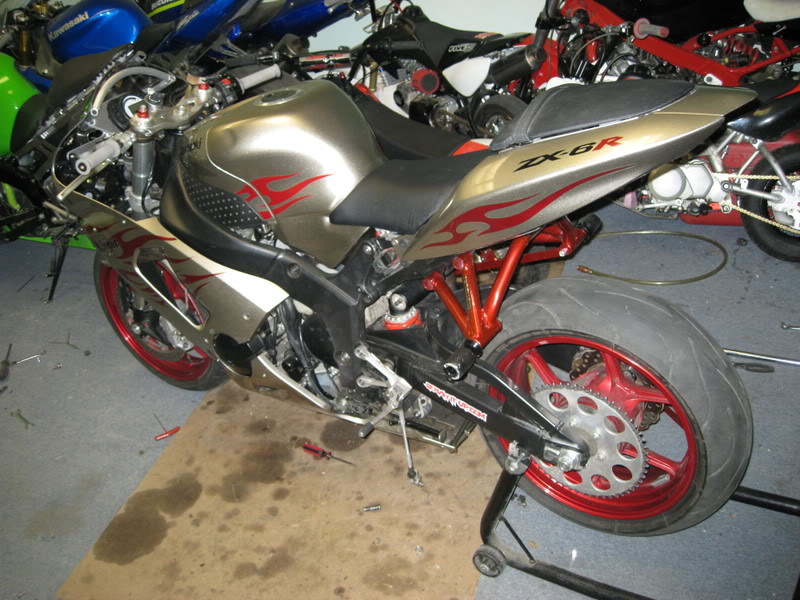

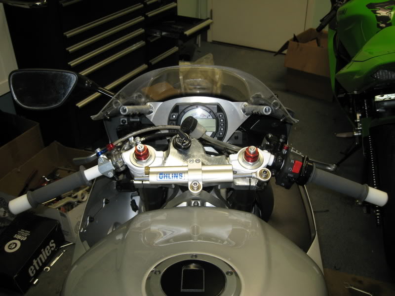

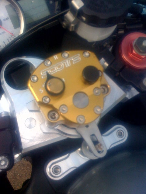

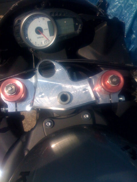

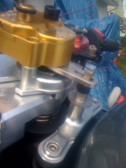

hell yeahhhh!! it works... i luv it to def... i am running a prototype on a 07 zx6r and it is hella nice...and it looks ****.... i am running stock turned out clip ons and a scotts dampner...also i have my front windscreen cut down to about 3 inches before the gauges...and the corners of the upper fairing are rounded...it fits fine for me... if you dont plan on cutting fairings it will touch the upper a bit but just adjust the clip ons back just a tad..and you are golden.... i surely would get it if i were you its a fine piece of work...and if you ever want to go db bars you are already ready for battle:YEAH :YEAH :YEAH :YEAH

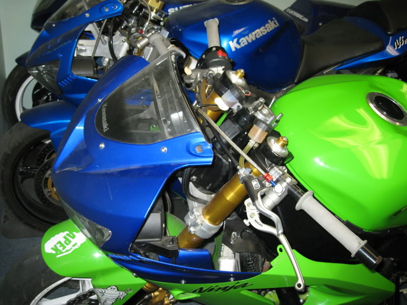

Heres my street bike with JohnnyP stay and OEM clipons tuned out...The throttle and handle bar swiches hit the upper before they hit my stay, its not a JohnnyP stay issue you, its a your upper it too long to do what you want issue...
If my stay gets in the way then you should have orderd a SHORT stay not a standard...The Standard length only works well with turned out clipons not flipped...If you want to flip them then any stay will probably get in the way, and its not only that you would have to cut your upper shorter too...
I run a short stay on my 03/04 and I can do whatever the **** I want with my bars and they clear everything, my buddy runs my short stay on his 05/06 and its the same we have alot of room to do anything we want...
