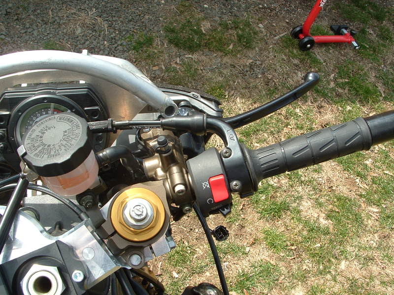

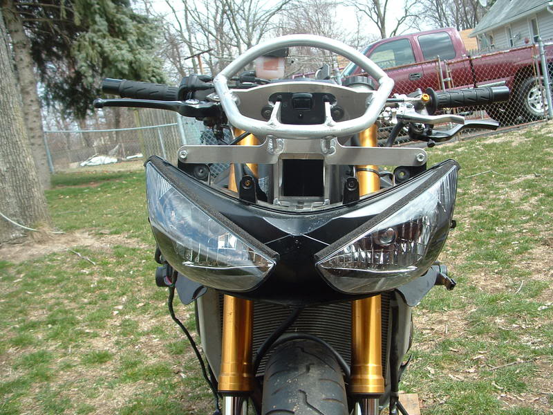

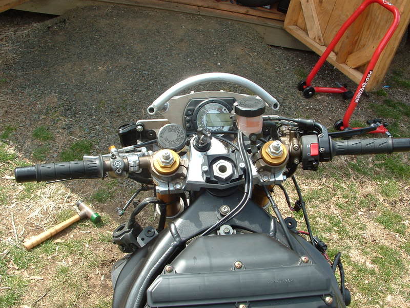

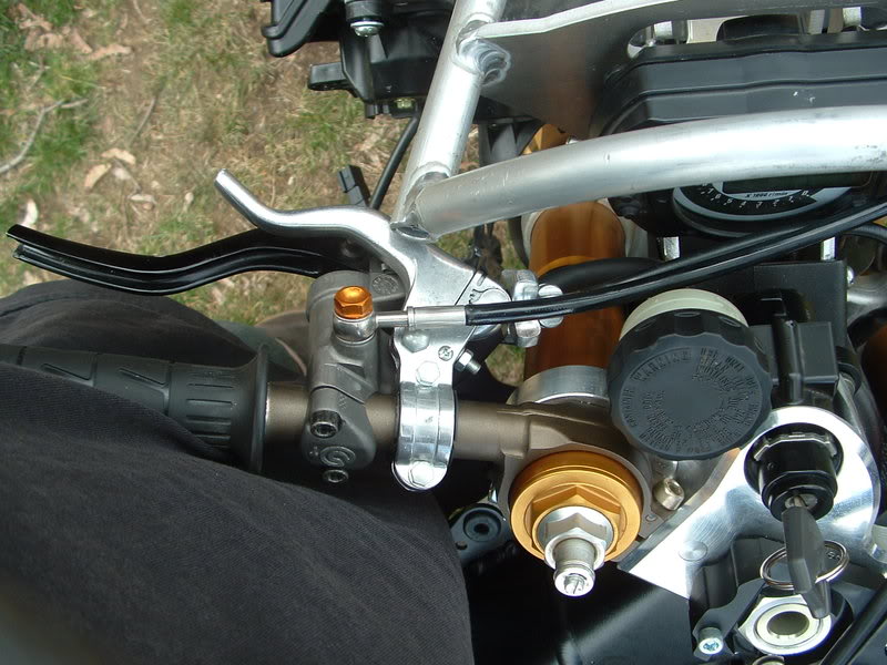

Just went outside and popped the stay in place before I finished my plastics. Yes it does hit on "My Setup". This is not a stab at any parties product. They both look great. Its just going to be a matter of finding a setup that works with what I got.
Some pics for your enjoyment..

We had the same issue on the right side throttle cables, rotate the throttle cable housing so the cables route under the front master not over. And you should gain clearance on that side...Also you might want to rotate your front brake master downward, it looks a little high (for me anyways) and might hit the stay at full lock....
And keep in mind your upper is going to need a serious trim job if you want to run your bars that straight out. Your lookin at cutting at least 6" or more off the top and sides...

That was an "out of the box setup". I might have to turn the clipons in a bit. The stock banjo on the front master wont allow a downward rotation becuase it hits the fork tube. I will have to trim off the tabs on the master and rotate the steel banjo out of the way. All said and done it should come out fine.

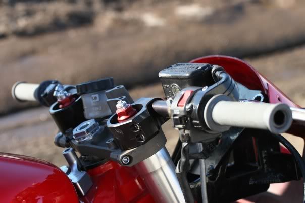

I have a Johnny P stay. I don't have a ho hey triple though (wish I did!)and I just hacked the stay down to the guage pod.. still looks awesome and holds **** in place.

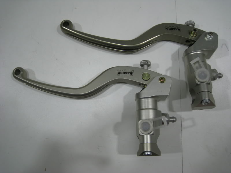

Talk to -SKETCY-, I bought 6 from him so far and hes a good guy!
He used to get them from a distributor and they only had like 2 in stock each time Id order, and you could only get the right hand masters. Now he says he can buy them direct from Magura so he can get left or right hand ones, and they have as many as you want...
I have the more expensive 190 series that are billet, but there is also a cheaper 195 fordged sersies

Hey SKETCHY did you ever get a chance to compare the 195 13mm to the 190 13mm? Are they any differnt in preformance?

Thanks. I just shot Sketchy a PM about it. So the 195 is a right handed cast body just like my Brembo 16X18 ?
Im not sure if the 195 forged version is available in a left and right, but yes the 195 series are just like the cheaper foged Brembos. And the 190 series are like the Brembo Billet masters, and those can be had in left and right....
