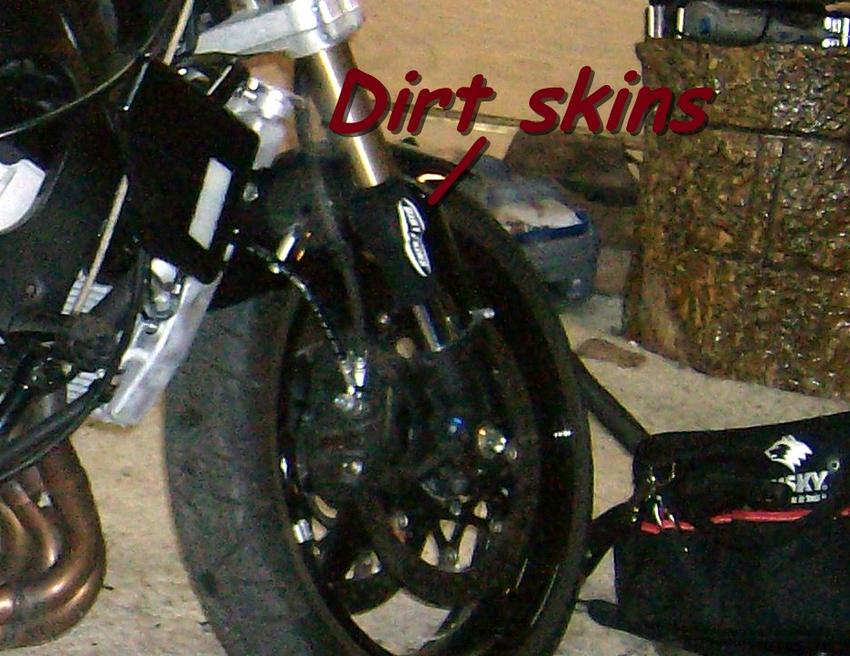

yea J, your are doing mine too, and I made a brass tool for them and everything on the lathe.... I never got mine to seal properly and I sold the bike.... So, I went ahead and got these now on the new bike before the fact, and all is well!
I anticipate no problems with these! At least these are supposed to help out...

Now towliee, let's talk about my KTM forks.. heh heh heh

those things skuur me , i always picture what would happen if one got sucked into the rotor and locked up my brakes
Wow, I never thought of that before?? That would be a one in a million chance, but sounds like an "only me" story too!
they are velcroed pretty solid, but my friend does zip tie his on the top and bottom instead of just on the top only like mine are.
Maybe I should put a zip tie on the bottom too....
I guess it COULD be possible
but after seeing Deeznutz setup, I think the seal savers looked plenty safe, and DOPE :YEAH
