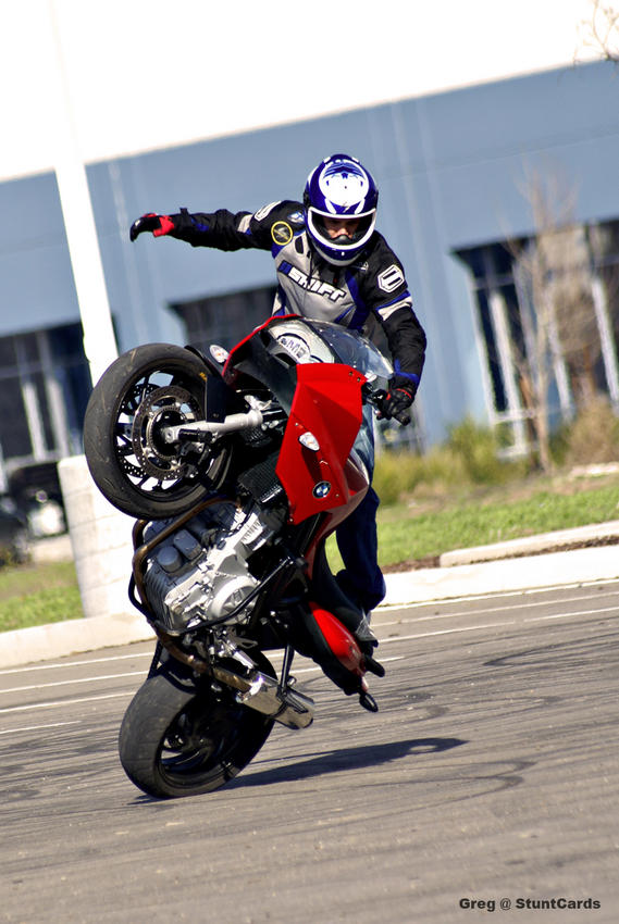

that being said, i tried it out today. first order of business was to relocate the master lower on the forks and reroute my lines. i had to bleed the brake real quick again and couldnt get the mush out of it, but after pumping it up, poppping a couple of wheelies...all it took was two cracks of the bleeder valve on the system and it was fine the rest of the day.
second thing i noticed was that i would like an ezpull/msr lever to use for the hb...the one bill sent is fine, but i think an ez pull on the hb line and one on the clutch will be super sweet.
i did a couple ss coasters and some ss circles, tight and wide. i liked the feel and response...had way better strength than my last brembo/ft setup on the RR but i didnt take care of that setup very well. it was sensitive yet didn't overbite. i can't really say anything mroe than that right now because the stock clutch lever is killing me and the gas/clutch/hb combo is not quite second nature on the bmw yet.
so overall, exactly what i expected and hoped for...and i can still go with more 'power' on the hb with the next adjustment, as well as use an ez pull. the footbrake was great all day with no problems whatsoever. i did not move directly from the foot brake to the hb while ina wheelie but it was fine on the ground.
you can check out some pics thanks to greg at www.beadyeyeproductions.com on www.flickr.com ...just look for beadyeyeproductions

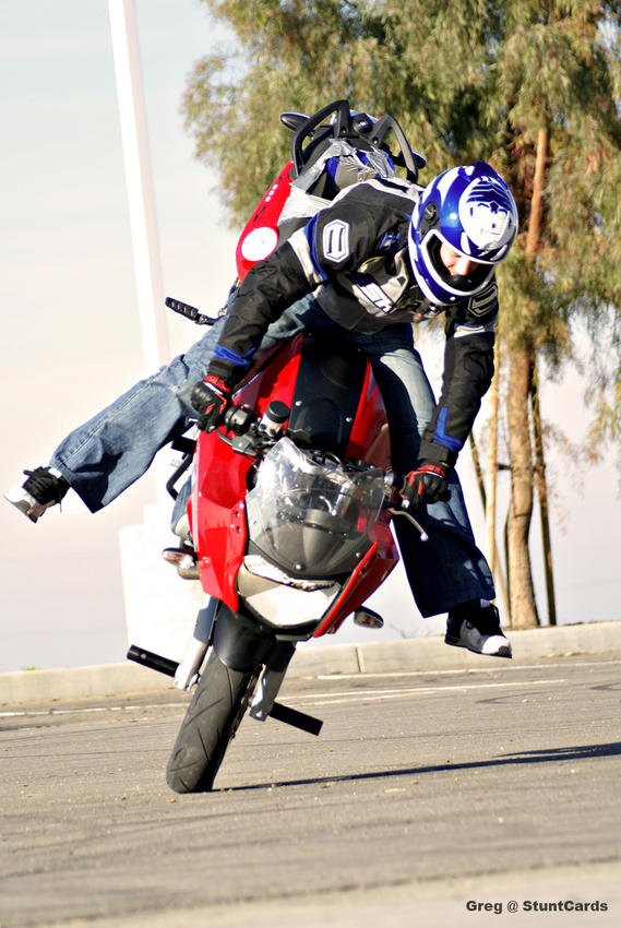

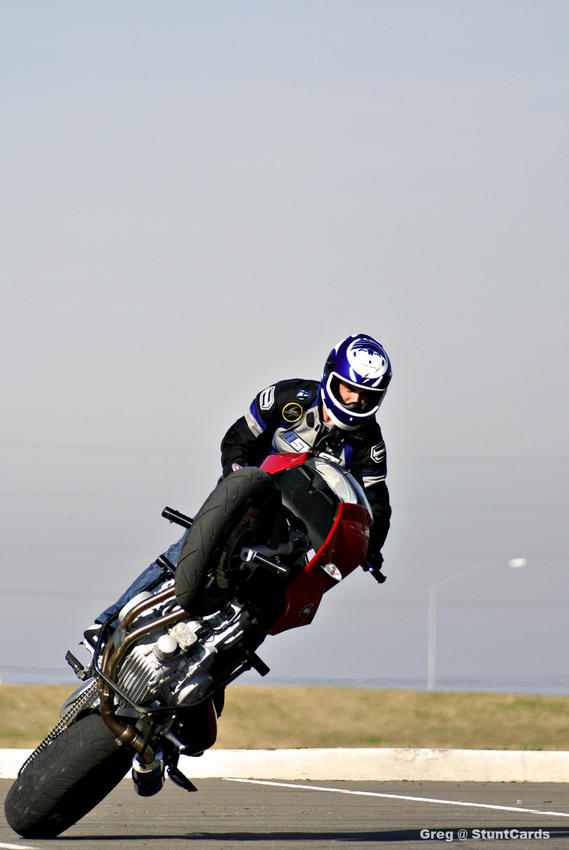

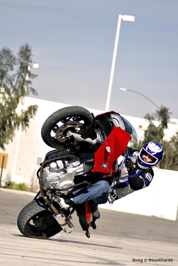

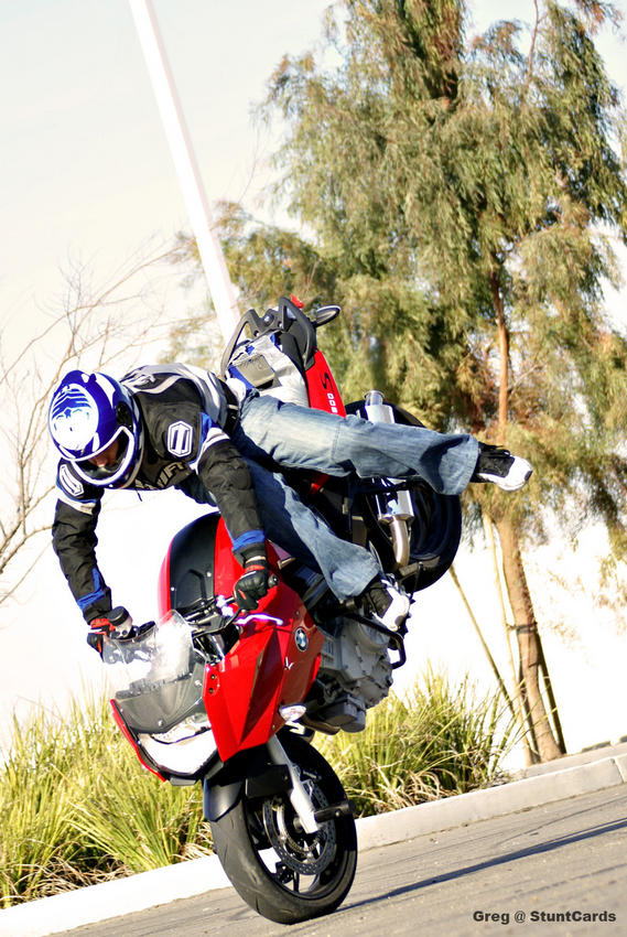

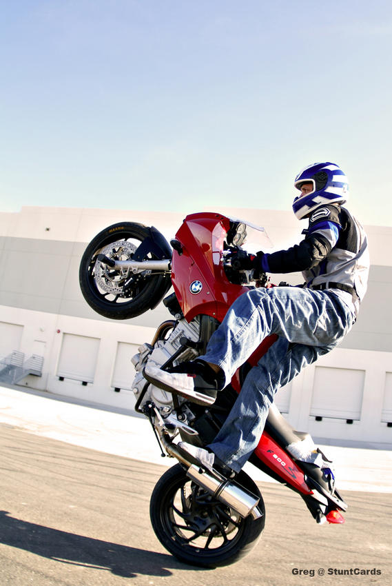

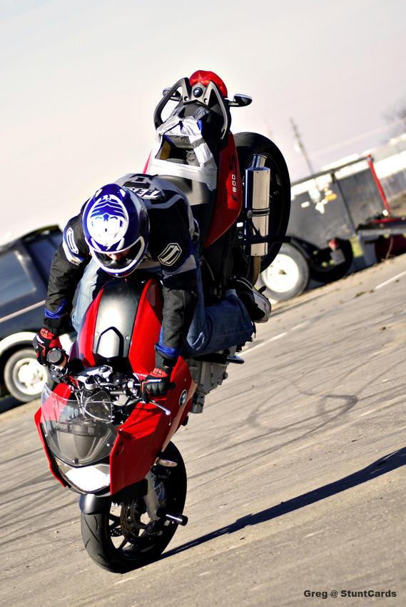

here's a direct link to the flickr pics...i'll try to post some here

this may be a completely drunk off my *** question but did anyone notice teach's banjo bolts are in different locations than what are in the sites pictures??? I hope his is a redesign because it looks better....but like I said in the other thread....without that top bleader port, this would be a bitch to bleed.
If you dont know wtf i'm talking about look at the lines that run to the master....on teach's there are 2 from the side and a bleeder above both....the pic on the website has one from the side and one on the top with no bleeder visible.
I really hope the production version is like teach's.....if not, i'm not buying

Re: The New Full Throttle Handbrake Report!
they all have the bleeder valve...two cracks after the initial bleed and a quick wheelie session to push the remaining air to the system, which is at the highest point.
and yes, D...I just finished an african safari...you missed it and the ride will reopen tommorrow! club moto i think
Name:	no footed 180 endo.jpg
Originally Posted by Darius
Teach you forget how to use the computer?
http://www.flickr.com/photos/beadyeye
you cracked the swing arm already????
ya, took too much out to accomodate a bigger sprocket...new one will be done tuesday. less taken out, will be fine. ride it like you stole it son!

Hey Teach,nice pics!Welcome to the club.
