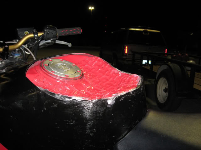

here is the one we did on my cousin's old 600rr and you really cant go more than this... maybe an inch more at the max... the best way to do it is dent the actual metal tank where you want it then use a heat gun to heat the UNDERSIDE of the plastic part.... try to spread the heat evenly yet fading in heat as you go outward if u get what im sayin.... then wrap a 2x4 piece of wood w/ a towel or something and work the plastic down starting at the cap and working your way outward.... you can also just put on welding gloves(heat resistant) but it may not come out as smooth. theres really not far you can go w/ a 600rr tank imo! good luck though bro!!!

my freind dented the metal tank, cut out the plastic and fiber-glassed the back to get a better lip. looks shitty but if you know what your doing it should come out good.

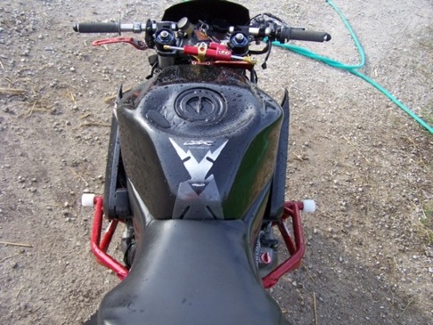

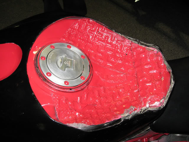

ok, I know you didnt want a "post ur pics thread" but heres as much as I could dent a top dent on my RR when I had it. If you went with an o-town dent I think you could go alot deeper!
tossed in an extra pic or two for good measure!
btw.....I dented the metal tank until it wouldnt go any deeper, then slowly melted the top down to its level. I think if I still had my RR I would prolly try a deeper o-town style dent...the space from the bars to the back of the lip on my tank was really compact, especially compared to my F4i now!

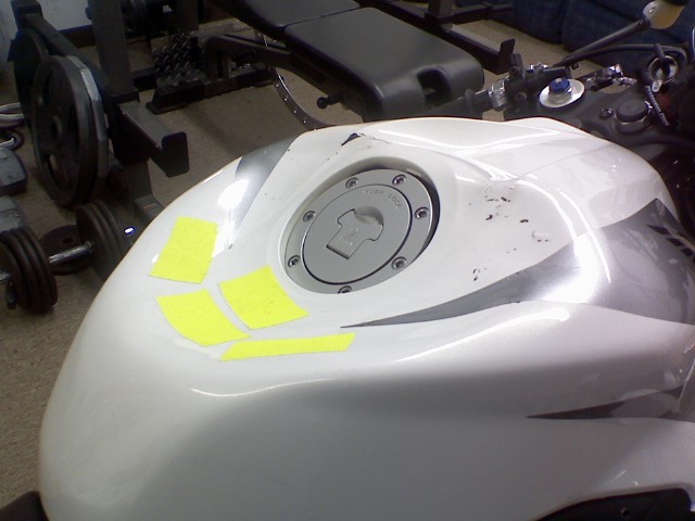

Hey Aaron, this is what my tank looks like bro:

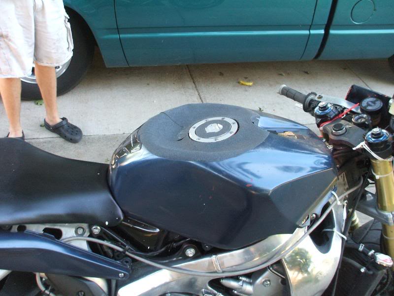

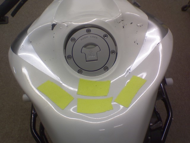

i have an 07rr. i just took the cover off and used a heat gun. you have to apply a **** load of pressure, and it takes awhile but i think it turned out ok!

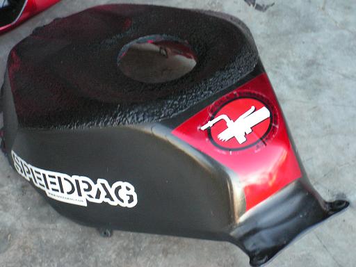

saw in a thread a while back that dude used a weight from a weight bench to help mold his plastic part of his tank, he also said heat it from the inside.
*j-brown(gixxer bro) had one of his tanks cut,then he flipped it and welded it back.how you angle and cut it depends on the type of dent you get.!!!!!!(had to cut the gas flap part out and weld it also.)<-might help you. IDK
