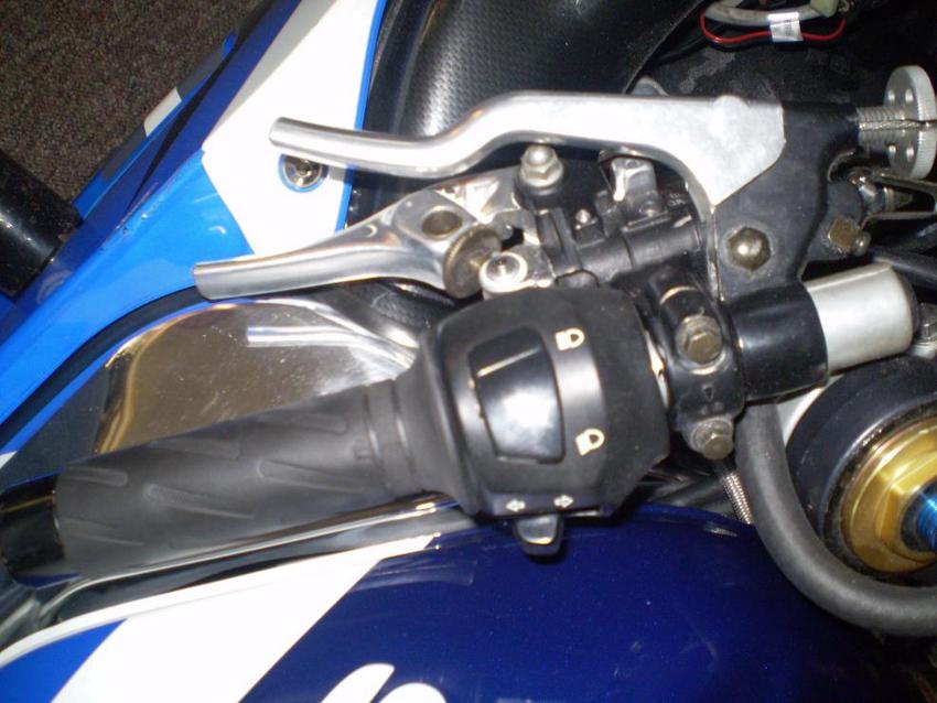

im running a msr lever now but it is shaved down just as much as the stock one. 02gsxr1000 master, i will take pics of the msr tomorrow. they are so close that my pointer finger gets hit with the hb lever, the levers act like scissors.
ID:	204872   Click image for larger version
why did you cut that hb lever down so much... your loosing a lot of braking power...

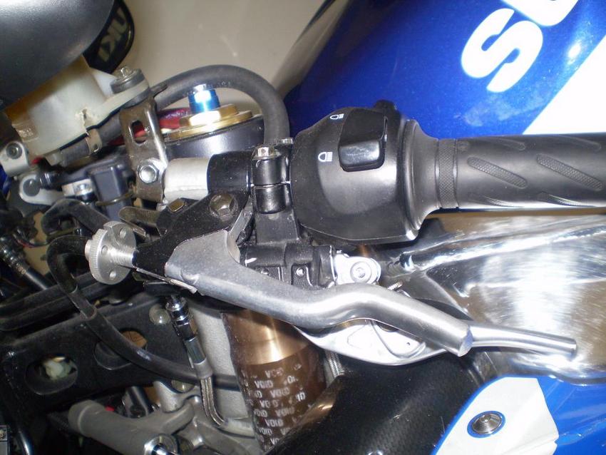

ok this is the most effective and comfortable setup your going to find.i have a brembo now along with a new bike but you get the idea...it fits the exact same way....
