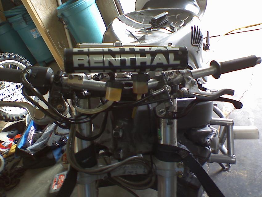

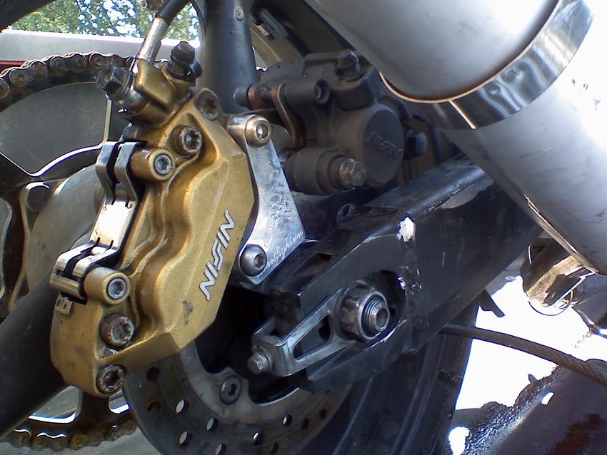

mines bled out perfectly, and before my current setup, it wouldn't lock the tire up with one finger either. not that it really matters that much....it was still strong enough to pull me back down from ugly highchairs, and was also smooth enough to drop right in and control seat stander circles, or NTH seatstanders.
My current setup WILL lock it up with one finger tho! Not that its needed, but its that damn strong. If thats what you're looking for, hit up HoHey or Guru and ask for the StreetFighterz edition dual caliper bracket. The thing is seriously sick, looks great, works great,....
looks like your using a front caliper on the rear - any specific reason
That's Ho Hey's new SF edition. It uses a front caliper for the hb.
well i know its the new edition i wanted to know why but my common sense just kicked me in the back of the head -
front caliper dual piston = more brake power
rear caliper single piston= less brake power
aaawwwee

front caliper=4 pistons, i like my dual rear caliper setup though,

its basically an exercise in overkill! hahaha I seriously love this setup tho. I have the brembo mounted on the other side of the clipon bracket next to the triple, putting my middle finger hooked onto the ball of the lever. I'm running new OEM pads on a 4-piston honda caliper for the handbrake, and everything stock for my footbrake. Setup works awesome. A lil touchy for people used to pulling the **** outta their levers, but for me, I move my lever MAYBE 1/4" while in SS circs and thats to pull it hard. Actually keeps my hands from wearing out.
