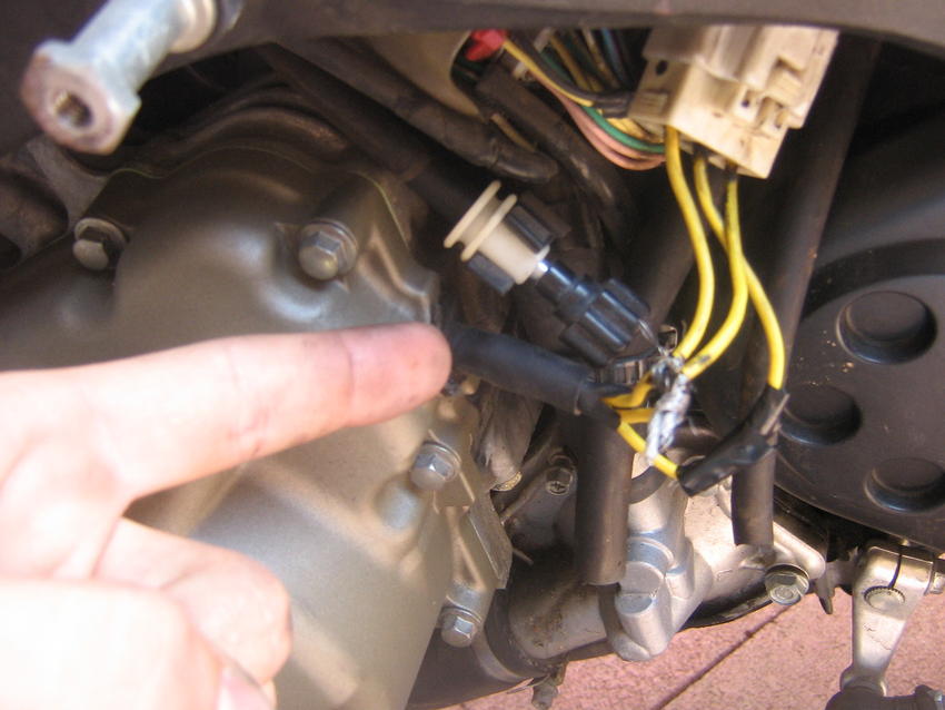

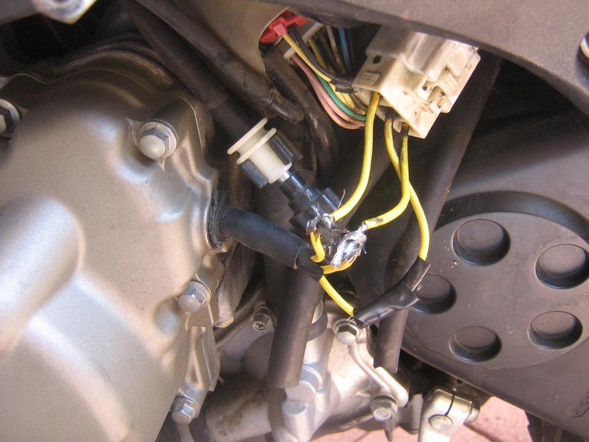

I dicovered today that my dog chewed threw some wires on my bike. They are on the shifter side of the bike. I know that it effects my turn signals, which isnt really a big deal. But my bike seems to be heating up really quick. When i took my fairing off and started looking at it I noticed that this set of wires comes out of the transmision (?) (im still new to motorcycle repair). I tryed to splice the wires back together, but it didnt completely fix everything. All three wires are the same color, so it makes it a pain in the dick to figure out which one goes where, but i tryed every possible combination of them. Normaly, after splicing them together wouldnt work, i would just get the whole strand of wires and pop them back in, but since this one comes out of the tranny (?) i didnt want to tear into it untill i had some more advice. So check out the pictures, and if u have any info/tips please let me know. Thank you.

its the three yellow ones that im talkin about

those wires go to your stator , they have nothing to do with your lites. they need to be soldered back together very nice and clean , if U dont you will melt your voltage regulator. It doesnt matter which wire goes where , all three make up three legs of the power generating circuit. But the reconnection MUST be clean , any resistance in a leg will cause meltage

damn! u think it would be safe long enough to ride it down to the shop? Its about a 5 minute ride. That also means that he ate more than just those wires, cuz my signals arent working (where do i check for that?)

fuses... first.... for the lights...
