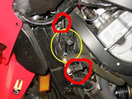

Here ya go. F4i full time fan wiring.

Hey whats normal stunting temp.. I got the fan hot wired and running at about 195 205. I know in a car normal is about 210 but dint know if bikes were the same.. am I Being A ***** Shutting Down At 208? What can I take it to before I get anywhere close to doing damage?
f4i fans dont turn on until 220 stock, so ya turning it off at 208 ur being a vagina...its fine

i had my fan wired on my f4i for liek 2 years straight if the key was turned on, the fan was running, never had a problem, ran like a champ the whole time...an keeps it cooler when sitting in traffic, if ur on the streets...
F4i, steps to wire fan on all the time
**ignore yellow circle it was an old picture an cudnt get rid of it
1. cut wire in the bottom red circle strip it down
2. ground it to the bolt in top red circle..tighten bolt..you're done

do u cut the black wire that is all ready grounded the one in the middle of the top red circle

no, just cut the one in the bottom red circle, strip it down a lil so bare wire is exposed an either crimped a rund fitting on there, to slide over the bolt when u tighten it, or just rap the wire around the bolt an tighten it...the wire up top does not get cut
