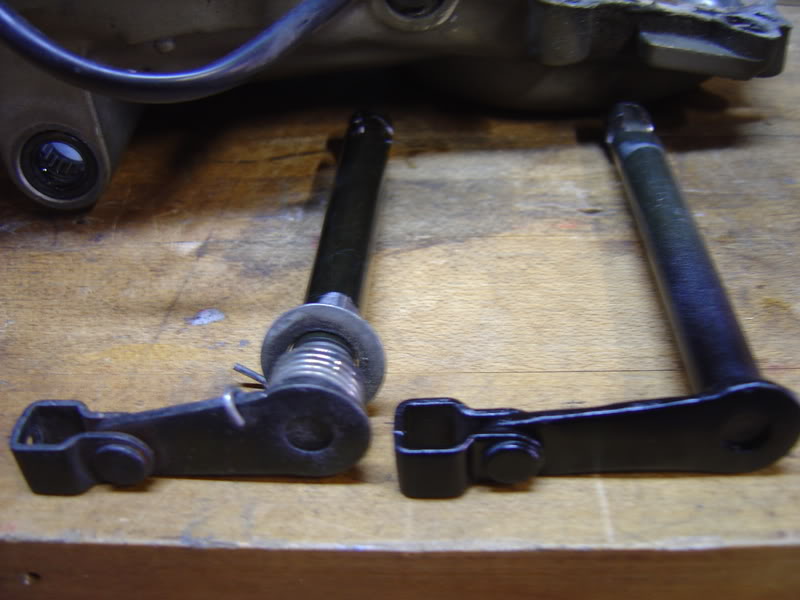

+100000000 - can you post up a pic OMR?
if the search function worked i would but i deleted the pics from my computer....
i just made the clutch release lever longer by 3/4 of an inch
can you do this on the F4I?

Re: clutch ez-pulls
yes but you can't go quite as long as 3/4 of an inch...
just make it as long as you can with out it hitting any thing
Old Aug 8, 2007 | 11:38 AM
  #71
Re: clutch ez-pulls
heres one jhonny p made notice the one on the right is longer...

OnEWhEeLNEAL's Avatar
NealFoReal
Posts: 36,000
From: QUEENS, NY BITCHES
Re: clutch ez-pulls
This dam search function. Fix it already. I'ma take pics of what I think you're talking about and post it up. Just wanna make sure I'm talkin about the right thing. Thanks.
Ok, definitely not what I was thinking about. Might be too much for me to do. Oh well, MSR it is.

Re: clutch ez-pulls
yea there ya go the red ones mine
