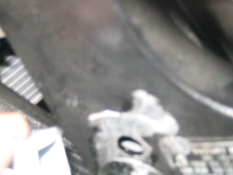

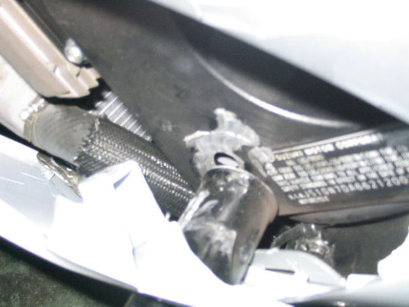

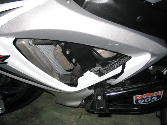

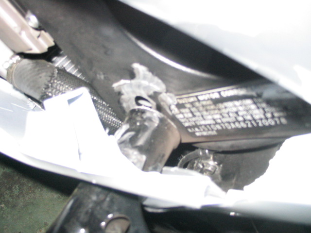

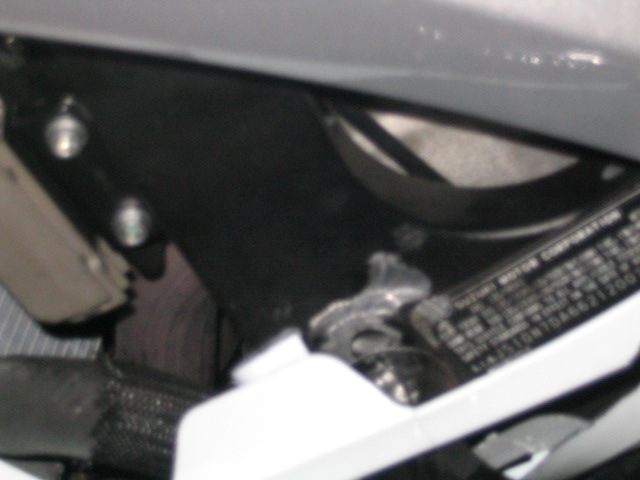

Haven't really looked at my bike since I looped it the other day but after checking it out today I noticed this dont look right. I dont do the work on my bike since I'm not mechanically inclined but looking at the bike/pics it looks like the cage used to connect to that hole somehow? Is the cage supposed to connect to the hole in the pic? That side is loose compared to the other side which is tight. Oh and its an 06 Gixxer 600 with the new style 905 cage if that matters. Thanks for any help.

looks like the cage bolt snapped off probly bent the cage to ****** chulla vista metal 905 cages dont take abuse well but some have luck with them

So what do I gotta do to fix it, from your experience? Is there a piece that I have to order from 905?
You have to get the old bolt out of the there and make sure the threads are ok. Then put on a new bolt.

looks like u snapped the motor mount, u prolly need to take off the fairings and see if u did.
i dont know how the new gixers mount the motors, but ur in for some work... post up when u or somebody that knows, knows more!

Take the faring off so you can see exactly what goes where. If the bolt is snapped off then you just have to drill out the broken part that is in your frame. No biggy there. If the bolt was strong enough (but probably wasent) and stripped out the threads in your frame, than you might be able to tap out the hole with a tap set and use a different bolt. Post up when you figure it out and for god sakes...dont take it to a dealer!

Dude, go to Lowes or Home Depot and pick up a bolt extractor kit with those treated carb bits. Use a bit smaller in diameter than that bolt and get a good hole in it. Make sure you use some machine oil to keep the friction down when you're drilling. Once you have a deep enough hole use an extractor and that bolt should come out. If it just broke off and didn't strip it out then you can go buy another metric bolt. If it did strip it then dril a little larger in diameter hole and tap it for a bigger bolt.

Right on, good luck. Be careful not to ground out the threads when you're drilling the hole for the extractor. Always go on the smaller side and go bigger if needed.

Take the bushing off of the end and see if the head of the bolt is inside the cage .
If you also bent the cage and the hole won't line up when you are putting it back together , i think you are screwed .
Maybe loosen the other cage bolts and try lining it up
