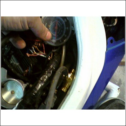

People were talking about how the Kleen mod will blow gaskets etc, it turns out its not the case-there is a vacuum of -1 to -5 psi at all times in the modified Kleen bypass hose.
I ran a gauge in a T-fitting and ran the bike hard under every possible cirumstance, watching the guage, when the bike is at idle there is -1psi, at idle wide open throttle its the same.
All through the powerband, decel, or accel, idle to redline it only fluctuates between -1 to -5psi vaccum, so no chance of blowing seals. It never came close to Zero psi.
The bike seems to lug lower, it might be in my head, but the thing has gotta run better because its running on clean air instead of dirty *** PCV gases being pumped into the airbox.

u gotta test the crankcase for pressure.
Old May 19, 2007 | 11:14 PM
martino's Avatar
wheres all the fat girls
Posts: 1,442
From: Northern Va
martino is a decent person
Re: tested:636 Kleen Mod generates vacuum only (pics)
that IS the crankcase pressure its reading. The measurement I took was right off the crankcase breather.
The crankcase never builds positive pressure.

were you taking a readying without the valve cover **** hooked to the gauge set, like, only take a reading directly from the crank case? and you seriously gotta test this underload... not just idle and reving... these ports are not very large to the exhaust valves..
i almost killed myself riding around with a vacuum guage in my hand, i hit it at wide open throttle through the whole powerband, wide open at 13k rpm made about -5 psi vacuum. btw are you a machinist or something, i was reading your stuff in the sticky thread, it blew my mind.
the only real question is how quickly the kleen can digest a massive dose of oil. I dont see how superheated engine oil would have any ability to clog a port.

id hook up a T fitting with a pressure guage, ( I used a vacuum guage that ranges from +5 psi to -30psi) it cost like 8 bucks, to confirm that the system is the same.
