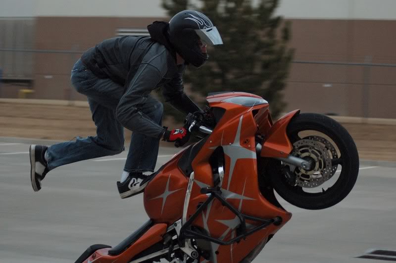

I used aviation snipsName:  Stunt2_24_091a.jpg
