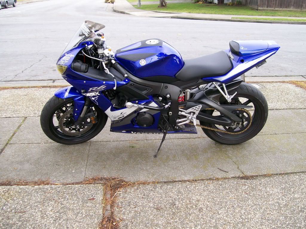

Any one here tested the powers stuntworks race rails? I'm thinking of ditching the FI cage for the race rails. I'd like some feedback from those who tried em.

I did the search and found a little info but it seemed it was only a few people who had them. I'm not worried about a scratch on the stator since mine has a scratch on it any way but IF the cage is going to protect more I will probably stick it out. I've scraped the cage in the corners and I want to be able to take a hard curve without having to worry about it. yet in the case I lowsided or dropped it I want to preserve as much as I can. My main consern is my plastics I dont want the bottom of my plastics to get jacked up if I dump it. I looped a wheelie last year at about 65-70mph (scraped the pipe causing the coke-bottle effect) and the bike slid and flipped and all kinds of shi+ and the FI saved everything I didnt have any damage to my plastics at all w/the exception of the tail and pipe. It broke a clip on but from the driver seat forward the bike was just as mint as before it went down. The cage was destroyed but it saved everything. I would like to have that same protection and If I can get it witht he race rails I will ditch the FI if its gonn scuff the bottom of my plastics I'll stick with the cage. I got a new cage on it now and the bike is puurrdy but I dont do any major stuntin just sit-down wheelies, stagerds and standups. and ride it everywhere.

I went down on mines,( got rearended by another bike at a stop and sent my bike skidding down the road..) as stated if you use the regular sliders that come with it, it barely scrapes the covers ( on either side ). Never had any clearance issues with it in the canyons, although I think I may get the extended sliders.

That race rail looks like it puts the case cover pretty close to the ground. Anyone ever have a hard drop with it?

I was thinkin the same thing Jay. What if the bike is sliding and it hits a bump in the road? These rails look good, but they need to be about an inch lower with another 1/2 in of slider

Just my opinion but I would think that the 3 or 4 point cages would be a bit stronger. If it starts sliding in any direction other than forward or backward, it looks like that the mounting points would allow the cage to fold.
I usually don't post in these threads but I am kind of interested on how that rail would react since it's a fairly unique design.

this setup has the old slider on it, i think Kane is runnin railz with extended sliders that will add like 3 inches

they work just fine. everyone bashes em cuz of the stator and engine covers are too close too the ground. i modded mine so i could still use the shogun sliders as the mounting bolt for it on both sides. neither stator or engine come close to touching nemore. ill try n post pics tom
