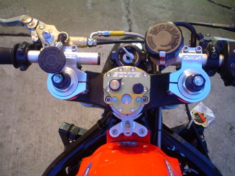

Well I Think A 929 Rr Front End Is Really Good Verse The 1000rr Front End Or The 954, Here R Some Pictures
Name:	MONKEY TACTICS 093.jpg
929/954 are the same, part numbers match and all
