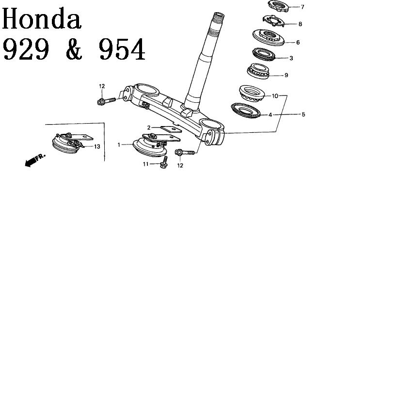

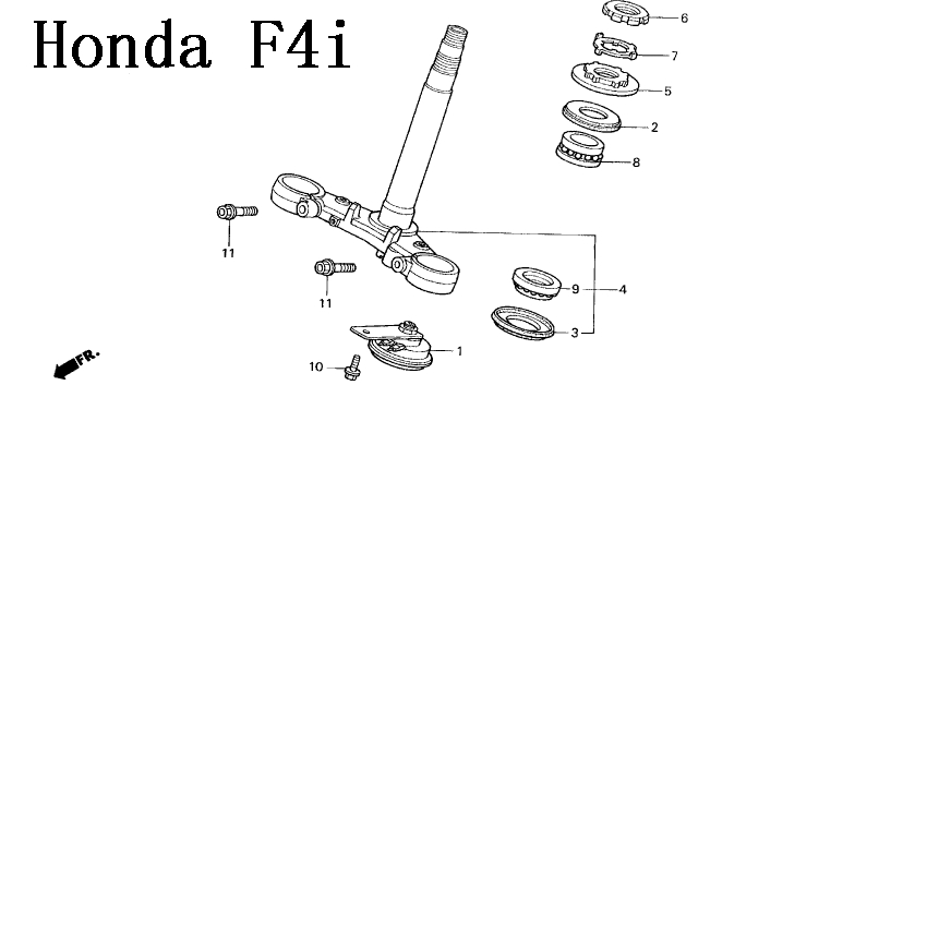

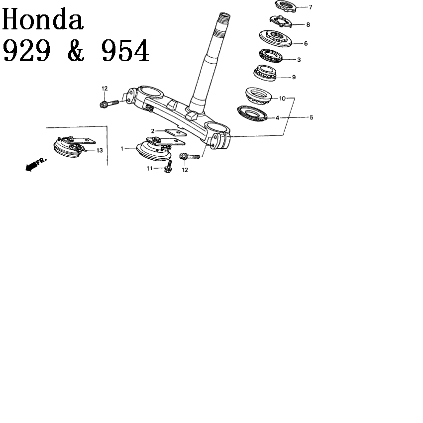

Hey guys I also am going to be swapping everything from a 929 to my F4i so how about bearings and hardware? Do you just use all of the hardware from the 929 meaning washer’s nuts and of course bearings?
File Type: gif
File Type: gif
Old Nov 3, 2005 | 07:43 AM
Ho_Hey's Avatar
Posts: 1,626
Ho_Hey is a decent person
Re: f4i with 929 forks?
Here are the pictures again maybe they will show up a little easier
ID:	157021   Click image for larger version

before you put the 929 front end on make sure you change the neck bairings
+1 on the neck bearings, pop out the little collars in the frame and put sealed bearings in there they work great. But to do this u will have to remove the bearing races off the lower tripple tree steering stem. As for the forks, use everything. Forks, calipers, rotors, wheel,clipons,tripples. and remove the ram air tubes from the bike and u'll be set

easy swap to do, i would just buy the whole front end though..., 929 front end bolts directly on, but the 954s came with tapered bearings as opposed to the regular bearings that come on 929s and f4is (making them completly enter-changable) as long as it has the correct races its easilly done
also a good point, 929 has the ball bearing type and will be usable. u can bolt it roght up. the 954 bearings are the roller/ barrel type bearings that wont fit the f4i neck. I put All ***** sealed bearings in mine and its turned out smoothe

Okay so when it comes to the bearings if you have the 929 set up your good easy no need to worry about changing bearings or races. Now if you have 954 set up your going to have to change out the races because the 954 uses sealed style bearings instead of the *****. My question for you guys now is where do I go to buy the new races for the 954 style sealed bearings and is it hard to remove and reinstall both top & bottom races?

Okay so if I go to a Honda dealer and buy the 954 top and bottom races NEW I should be able to swap those out with the ones in my F4i pretty easy? I just want so make sure someone has done this and hasn’t screwed anything up trying. I thought you had to have special tools to remove and replace races?
I would also like to ask are the 954 roller/ barrel type bearings really worth going through the hassle of changing out your F4i racers to the 954 racers so that you can have those roller/ barrel type bearings on your bike? If its makes a noticeable difference I am down to changing the racers on my F4i to work with the 954 roller/ barrel type bearings
