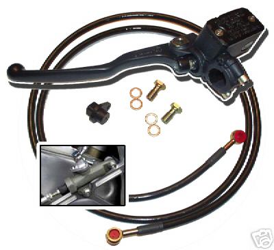

is this garbage
is this a good set up /deal? 200$

that is junk .... don't do it man..... you will just have to buy another master later

most people ive talked to dont like the res like that ???????/

sure, but u could score a line, adapter and good rad. mounted m/c for about that if you shop around like say on ebay. The resivour will interfer w. the clutch cable too

whats the good size of the brembo everyone likes again? 16x18??
that master is a turd! impossible to set up on the bottom where you need it. My boy has the rear master fitting welded on and it works like a champ. But do not get the full set. Just the fitting. Then spend the 200 and get a brembo 16 x 18 you will not regret it....i know i dont. oh you can get the fitting from here
http://www.haibikeshop.com/store/ind...&products_id=4
and the brembo
http://www.haibikeshop.com/store/ind...oducts_id=1063
then find a rubber and gasket company in your area take them your measurments and your rear brake line and have your braided lines made for half of what they cost online.

I think the only "advantage" to the brembo is its compact size.
+1
I had so many problems with other masters not being able to be mounted close enough together with the clutch. Tried them what seemed like 100 different ways. bought the brembo and had it mounted where i wanted it in like 5 minutes. and it has better feel than stock units also.
brembo+moose+fullthrottle 4 life!!! :YEAH (or at least until somthing better comes along)
