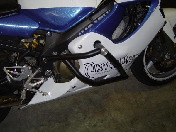

ya i made my own and i went with a cross tube in front of the headers, motor mount bolt, and the subframe bolts. mine cost me about 80 bucks i used 1-1/4 .120 wall chromoly for all the long tubes, i made the frame slider part out of 1-3/8 .120 wall chromoly, and the through tube out of 1" .120 chromoly. and i slugged the tubes where they bolt up 1/2" in the tube. i used 3/8 bolts for the subframe 4" and just 3/8 1-1/4" length for the cross tube. and made a 2-1/2" treaded slug for the bottom tube that i spot welded and welded the end. all tig welded of course.
heres some pics
heres some pics
you made that>? dam that **** is sweet

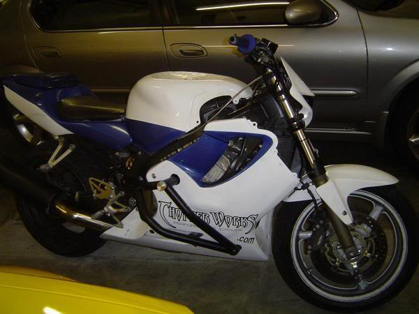

Re: making my own cage, help!!!
heres a buddy of mine subrame. He fabricated this for his r6 since the r6 subrame is so weak its one big peice..strong as shitttt
