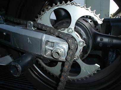

i was riding a spreader today and my back sprocket broke!! what the *** , anybody with the same experience, personally never seen this before, it was a 520 kit on a 636, is it a good idea to go 525?? it sucks!!!

that thing dosent look very strong to begin with

Yeah the holes are waay too big. What brand?

holy **** that so cheap
if it did not have those holes it wouild of not happened
who ever made the holes he kind of a retard

636's come with 520's
sprocket looks custom
whoever made that was a retard

yeah, that sprocket looks way too weak!

Wow, that sprocket looked too weak to begin with.... I agree with everyone on the holes being to big......

If if was me I would have stayed with the 525 or went bigger rather than smaller. But like they've said, the holes look too big. I'd send that POS back to where you ordered it from.

520 530 525......it dont make a ****...that had nothing to with the chain and sprocket WIDTH...that all all about shitty design on that sprocket...and that was homeade piece of ****......anyway...I have 520 on my 636 and never a problem...got 20,000 miles out of it and i gave it pure hell...........

Thats it they simply took away too much material and the surface area left wasnt enough to hold the load....

The big holes looks like what the problem was at.. Look at the distance between the hole and the teeth..
Also don't run 520 - Use 525+ chain and sprocket stronger..
