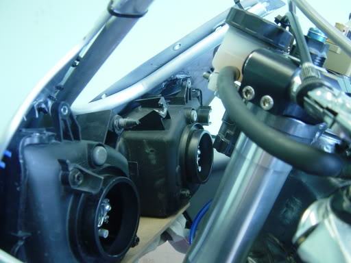

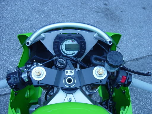

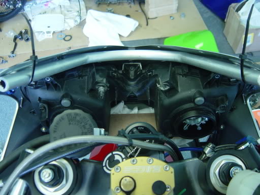

GEN2 03-04 636 stay installed:YEAH These things are ready to be produced, soon as I see some serious intrest I'll dump my money into them and I'll have them ready to ship within 2 weeks....And Ive found a company with a larger waterjet machine so I'll be doing runs of 25 pcs instead of 17, as they can fit a larger sheet on their machine......
And I just had an F4i dropped off to me last night for prototyping, thank you Wheelieking I should have the prototype for that ready in the next week or so, just have to turn the ideas in my head into real parts Then its up to my friend Wheelieking to crash test it I didnt think the OEM F4i stay was so crap, They mixed 1 part steel with one part aluminum and it still falls apart....

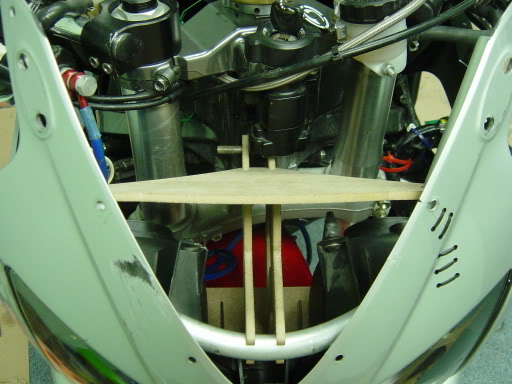

F4i prototype stunt stay V1.0 sneak peak..........Just finished the design and cut it out of wood to test fit, it fits good and even though its only wood it supports the headlight much better already as Ive made the stay to hold the underside of the headlight. So off the drawings go tommorrow to the waterjet cutter, and I should have one welded up for my buddy WheelieKing to test this weekend...Let me know what you think.

Damn, that 03-04 stunt stay is ILL looking...the only thing I wonder is will the aluminum be more prone to cracking then the steel ones that 905 makes?

I had the 905 prior to making mine, my V2 is better and stronger than my V1 and my V1 blew the 905 away in terms of how well it worked to save me parts.The problems I had with the 905 are the plate was too thin and it would shift left and right, it uesd the OEM guage stay and that would crack very easy and its expensive, and it didnt support the headlight any more then the stock one. My V1 would bend eventually after crashing hard and looping a few endos it cracked a weld or 2, but I would just bend it back and reweld it. I used it for a whole season and untill I made the V2, and my V2 is stronger and Ive tried to elminate all its weakness...
