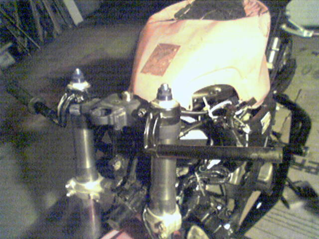

This is how im going to try them. If you flip them and leave them below the triple theyre rediculously low

Wow that looks crazy

reminds me of a cafe racer kinda

wow those kinda **** cause if you leave them stock they have the downbend and if you flip them they have that up-side-down rise that puts them really low.
Mike, find out what size the forks are, most up-side-down setups are 50mm (GSXR's, 636, zx-10 just to name a few) If they are 50mm then ANY 50mm aftermarket clipons will work, and you can flip them and they will be haigher than those, even UNDER the triple... ill bet you can find a set on e-bay, if not hit up Freestyle Ing. and tell them who you are and they'll probably give you a decent discount on a set of ) degrees!

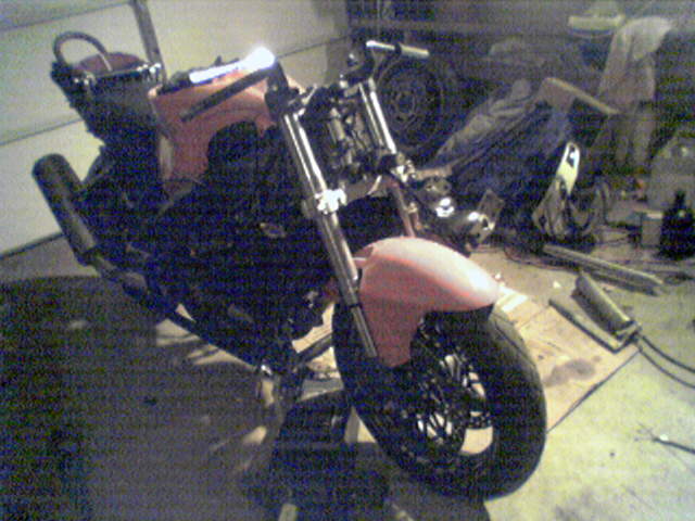

i was tucking through with the f4i front end with stock clip ons turned out. that reminds me its time for me to stretch
here is over the triple, not flipped. they're like apehangers up there, way too high

Doesnt it look like my fender and tank match? The fender is dark red, the tank is light orange. strange
