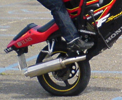

heres mine, i used a chop saw, and had a friend tig weld it.
ID:	176116   Click image for larger version

I cut my standard pipe down with just a hacksaw then had it welded all up.. I cut the bottom end of the pipe off so didn't have to **** with any of the cylinder pipes and stuff, only downside was had to grind the hanger bracket off and have it rewelded in the right place... didn't cost me much to do at all, its still pretty quiet.. i made it short enough not to scrape but left it as long as possible to keep it relatively quiet... looks alright to me, didnt cost much so i cant complain...
i reccomended cutting the bottom end of the exhaust, the end with the header pipes on, as then you dont have to **** with the inner stuff... i only cut 5" out of the can, but it does the trick thats all that matters.
