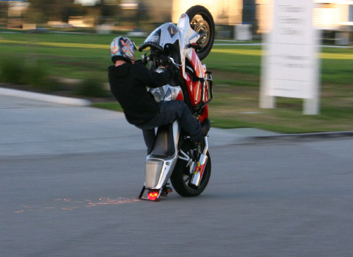

Hey guys. Was hoping to get some advice on bar length for real stable scraping. Like I see the dudes that do watch towers and other bar tricks where the bike just stays on the bar whilst pushing along at idle. The bikes seem to stay real solid and stable and they can then jump all over that sh*t like a monkey Well I've been trying to get the right length sorted on the F4i but cant get it that solid. I've already cut some of the bar off to get it shorter but its still not solid enough to roll on its own. Just thought I'd get some advice before I cut too much off. So if anyone who does those bar tricks has any pics of their 12 bar it would bloody rock!:YEAH

Thanks heaps Scott That's given me a good idea of whats wrong with mine. I've cut mine in too much. I can see that your 12 bar is out a lot further then where mine is and that makes sense cos it was more stable before I cut it back. I should have moved it out an inch instead of in
See the pic of mine here. This is where it was when I first set it up. Now its a bit shorter then that.
